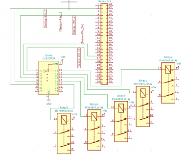

While working on the project for my Bachelor's Degree in Mechanical Engineering I've come along a strange little problem and i'd like to ask if the following behaviour is happening to anyone else and how to deal with it.
Whenever I'm uploading code onto my Teensy 4.1, there obviously is a kind of reset. When trying to use the Teensy in the following circuit, I could hear some of the relays switch.
That means that there has to be some kind of voltage applied on those pins during the reset. This results in a short lasting but unwanted connection over the NO-pins of the relay.
When testing which relays had switched, I found out that only relay1 and relay2, which are connected to Teensy 4.1 pins 24 and 25, got their switching voltage applied.
The other relays remained in their non-switched-state, eventhough they're wired up in the exact same way and handled by the code in the same way.
While trying to locate the problem, I decided to remove all of my developed switching circuit and also started up a new code.

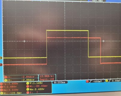

I measured the output voltage directly on the Teensy Pins with an oscilloscope while uploading code which only function was to define all digitalpins and to put them on LOW.
There are no other electronics connected than the external 5 V, the USB-connection and the oscilloscope.

I iterated this test by measuring every single Pin on the Teensy with the oscilloscope and registered that only Pin 24 and 25 apply a voltage of 3,3 V on their outputs while resetting.
No other pin applied voltage during the process. On a second Teensy 4.1 the exact same problem occurred.
The only thing I changed on the Teensys is cutting the PCB-bridge that connects the external 5 V input and the voltage of the USB-input, as the Teensy needs the usb serial port for communication while being powered externally
As I can't change the usable pin due to an ordered pcb, I had to implement another small extension-pcb.
This pcb contains even more relays that are used as a first stage switch, to prevent the unwanted connection over the relay.
The relays are activated as the first stage, after the teensy has finished resetting.

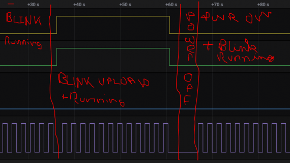

What I am seeing is when I upload a sketch (BLINK.ino) I see pin 24 going high using a LED breakout board with leds on all pins. Then it goes off like shown in your scope shot. But if I turn the power off and then back on pin 24 LED stays dark. So if it was a bootloader issue wouldn't pin 24 blinking wouldn't show on each power cycle? Looks like its only happening on uploading a sketch... I am not seeing pin 25 light up but that doesn't mean its not - may just not be visible.
Also if you look at the bootloader sequence shown on https://www.pjrc.com/store/ic_mkl02_t4.html doesn't involve pin 24 (AD_B0_12) even if its an issue with JTAG not responding (look further down on the page to troubleshooting section).
So maybe its more associated with teensyloader?

Use a USB Battery box and push the Button - the pin 24 shows up - (wasn't watching #25 as I thought that was off): Not Host software - the bootlooader MCU is in control of the MCU ... OR wants to be ... and putting the MCU in 'that state' it is powering those pins.
(noted above) The ORANGE PJRC 'edge pin' LED board resistors must MUTE the Pin #25 to the LED - use an alternate LED or DVM on pin 25 and voltage is present - fooled me too.

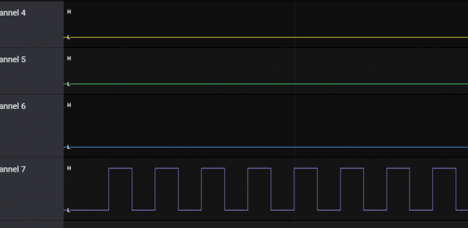

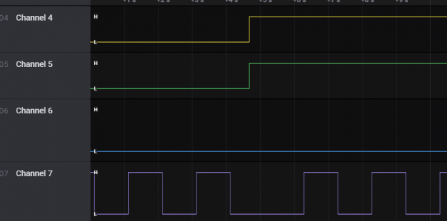

Ok. Hooked up a LA to pins 24 (channel 4), 25 (channel 5) , 14 (channel 6) and 13 (LED).
1st section shows sketch running and pins 24/25/14 are Low. Reloaded the Blink sketch and with the Blink Sketch running Pins 24 and 25 go high and stay high. Next I recycled power (Off and then ON again) and notice pins 24 and 25 show low which is what they are supposed to be.
And if I just power the T4.1 running blink off a battery pack (5v + GND):

While on Battery - can you show the graph when the Button is pushed. It will match to some degree HIGH on #24 and #25
Can you wire in the Program Pin as well?
Also: in the first graph - LA shows zero, but it seems as it the voltage IF HIGH on Reset (powering an LED) - the 'Keeper' works to maintain that voltage w/low current.

Sketch running and then power button pressed:
That is what I saw and expected would show there. Running on USB power - no HOST or Teensy Loader online ... This is what would happen with an installed device and the button triggered while Teensy sits in Bootloader mode.
"Power Button" ... "Program Button"
Sorry but I think we got our wires crossed that was with usb + teensy loader uploading the sketch with the png button. Will rerun in the morning just on ext pwr
The theory is that they are "input pullup" in this state. And this is weak. So it would help.

I could observe the same graph on my own oscilloscope when pressing the Program Button as in post#15 by mjs.
And I also get the same graphs from post#13 - which means that there is no voltage applied, when the Teensy is started up without trying to upload code.
Based of that, I could get a way around the Teensy switching the relays:
I have to remove the Teensy from my PCB, power it up externally, wire up the USB, upload my sketch, power off, put it back onto the PCB and power it up again on there.
In this case there is a fresh code and no unwanted contacts via the relays involved.
However as this takes a lot of single steps while testing different codes, I'm open for any other solution!
