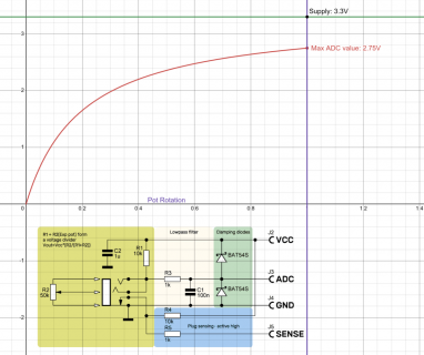

Made this simulation:
It shows another drawback of this solution: R1 + pot inside the Expression pedal create a voltage divider with the variable bottom resistor. This changes the taper of the pot, assuming the ones used in expression pedals are linear ones. Ideally the output should also be linear with the option to remap it in software.
V sets the bus voltage (range 3.3V to 5V)
R1 sets the value of the top (3.3V pull up) resistor
R2 is the pot resistance inside the expression pedal, range set for typical values found in expression pedals (10 - 100k)
Play with the values and see how the curve and the max output voltage are changing.
Diodes are there for protection. They will clamp negative voltages to GND and anything over Vcc+Schottky diode drop to Vcc.
R1+C1 filters the noise, plus R1 acts as current limiting resistor for the clamping diodes.
GPIO on the Teensy is configured as Input, it won't be supplying any current. It has to be protected against something external trying to push too much current into the pin. It is a common way to protect the input against a voltage spikes which might appear for whatever reasons (ie. user plugging something else into the exp jack).

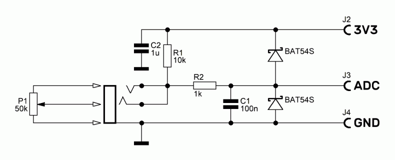

Hi @Pio, I really appreciate your time in explaining all of that, plus the demo link. Very cool.
I want to be able to reverse the pin definitions in software, and not rely on an external switch if possible. I don't see the circuit above being reversible without an actual hardware switch, as the connections for the ADC and the 3.3V lines are not mirrors. Maybe I'm not fully understanding how you envision it would work.
But I'd like to define ADC pin as INPUT_PULLUP, so no need for the 10K resistor since it's already part of the Teensy, and define the 3.3V pin as a digital pin outputting HIGH to obtain the 3.3V.
Then if the user has a pedal that operates with wiper/3.3V reversed, I'd like to just have a setting they can change, and then reverse the pin definitions on a reboot of the Teensy.
I'm also not a fan of the extreme non-linear response, even using just a 10K pot. It's really distorted.
The shottkys' are not clear to me - you show two of them, but the BAT54S is already 2 in a row. Perhaps you meant for one shottky to be connected with the middle terminal in between, as they internally are wired like this:
So would your circuit just use one BAT54S with the middle terminal 3 connected to ADC? Otherwise I'm not clear on how you see connecting two of them, unless you mean to ignore terminal 3?
Also, is the function of R3 to limit current to the ADC in case of a voltage spike? Or is it part of a filter?
In any case, you're given me so much to think about and try to understand, and if you don't have more time to explain or share that's OK. I'm deeply grateful for what you've already given me.
I did not have a symbol for dual BAT54S, so i've used two diodes. It's just a schematic to show the idea, not the final design.
The of the diode is also non critical. BAT54S are conveniet having already two of them in correct orientation. 1 goes to GND, 3 to the input signal, 2 to 3.3V.
R3 + C1 forms a lowpass filter. R3 limits the current going into the diodes at the same time. It does both.

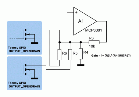

Now, a way to improve the design and make it even more safe for Teensy against all the unexpected operations users can perform on the input EXP jack would be to add a buffer/amp for the voltage signal. This is actually the way i've been using for years. I remember having issues with long cables (exp pedal input, shielded 2 wires) plugged directly into the ADC input. It was long ago in the ancient AVR times, today's ADCs might not experience such problems. I've put a buffer there to further isolate the MCU input from the outside world and to drive the drive the ADC with low impedance output.

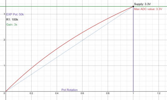

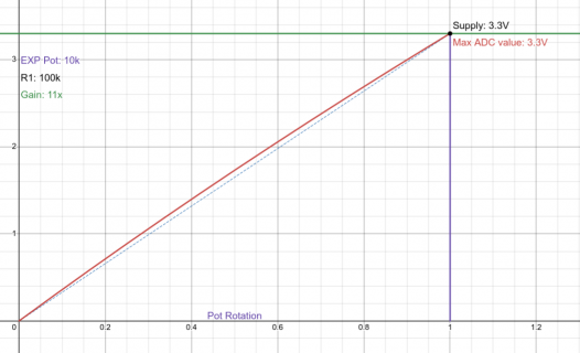

Let's add a simple non inverting gain stage. This allows us to do two things:
1. Increase the R1, thus flattening the response curve for the typical exp pedal pot values
2. Adjust the gain to fully drive the ADC input range.
The new schematic looks like this:
Simulation with a new parameter added: g (opamp gain)
I have limited the range of the expression pedal pot values to 10k - 50k, since these are the most commonly used values. 100k/Log is used in Volume pedals.
Worst case scenario is a 50k pot, we need to add a gain of 3 to bring it back to 0-3.3V range
With 10k pot the curve looks close to linear, it needs more gain, though: 11x.
The gain stage has a tiny trimpot, user can set the expression pedal to the max position and adjust the gain. Teensy can then read the ADC value and once it close to the max blink a led using another pin to inform the user the setting is correct.
That gain could be just a buffer if we don't care too much about the ADC resolution. Perhaps doing the gain stage in software + adding a lowpass filter would smooth out the expression pedal signal enough.
Still, one of the tasks for the opamp is to isolate the ADC input, having it there already, why not use it to boost the signal to fill the ADC input range and use all the available resolution.
Sorry for the long post!

R+T tied together - this is what i have been trying to explain in the previous posts. Maybe this picture will explain it better.
Let assume we have the Exp pedal jack configured as: T=signal/wiper, R=toe position/pot top setting, S=heel position/min setting.
Plugging a pedal with a reversed R+T will create a short between the R and S in the minimum position. R is where usually some kind of reference voltage is supplied. Might be dangerous if it's a 3.3V rail unless it has a current limit protection.
Using R1 =100k and connecting the R+T creates a classic two resistor voltage divider with the bottom resistor being the pot inside the expression pedal.
And that's it. No need to do any complex rerouting, switching etc. The only price paid for that configuration is the non linearity, which as shown above can be limited and perhaps even calibrated out in the software.
A bonus is such an input can be used for a footswitch, too. It had to use a TRS jack, though. A mono TS jack would cause a permanent 0V reading.
What i would probably want to do with the previous schematic (with the opamp stage) is to eliminate the trimpot and do the gain setting automatically. It's not like the pot values can have a value of anything between 10k and 50k, rather 10k, 20-25k and 47-50k being the standard values. One idea could be to make the opamp gain control switchable instead of continuous, giving the correct almost full ADC range with the final adjustments done in software.
This could be relatively easy with Teensy's GPIOs configured as OUTPUT_OPENDRAIN and using a combination of 3 resistors:

Hi again @Pio, I have a question about the op-amp version of the circuit.
I understand that RV1 controls the gain of the op-amp. I also notice in your simulation, if you change the expression pedal from 10K to 50K, the voltage can spike super high instantly if RV1 is not adjusted prior to inserting the pedal jack.
I'm wondering how safe this would be for the MCU? Forget using a digital potentiometer for a moment for RV1 - if you were doing the adjustment with an actual pot, it would have to be done before a pedal is plugged in or there's a risk of the gain being too high and the input voltage to the MCU being way too high. Am I understanding this correctly?
Can you help me understand this a little better?
I'm sorry to ask so many questions. I've spent a lot of time with the awesome schematic you shared, and I just want to understand it better.
I appreciate it.
Mike
Opamp is powered from the same 3.3V as the Teensy. If the gain is too high the signal will be simply clipped at that level. The amp can't produce an output voltage that is higher than it's power rail. At least not in this application.
In practice it will make the expression pedal reach the max value much earlier than the toe position.
Thank you so much for explaining this!
