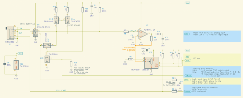

Hi again @Pio, I am going to be building this in EasyEDA to test it, so I translated from KiCad the schematic. I know KiCad can do it all, but I've used EasyEDA for a couple years and am more comfortable in it. Plus you can generate a PCB automatically and have JLPCB build it too.
So here's your schematic, translated again into EasyEDA format.
I wonder if by chance you, or anyone, can help me proof it? I've gone over it twice very carefully, but it's so easy to miss obvious things. Plus sometimes I get confused/perhaps slightly dyslexic when symbols are turned around, which I can't help when using other libraries with their premade symbols for components.
Thanks so much, and I'd be happy to share the EasyEDA project files too if anyone wants it.
Bottom row of 10k resistors + MCP4018 needs power. Add VCC to the left side of C4.
C4 should be placed close to the pin1 of U3.
Excellent catch @Pio ! Thank you so much.
Corrected...
If you see anything else please let me know...PCB Layout adjusted to put C4 near pin 1 of U3, although not reflected in schematic.
I appreciate it so much.
Mike

I don't understand the use of D1 which seems to protect C6 rather than U1. Also why is there protection on the tip but not the ring of the jack?
D1 clamps the voltage coming into the opamp. For the ring, you are right, RC filter does provide some protection for the Teensy GPIO, combining R9 + Teensy's internal clamping diodes. I think, since there are two signals, i could throw an USB ESD protection chip there. The built it Zeners are usually 5V (USB VBUS) and won't do much in 3.3V, but it's a compact solution for two pairs of clamping diodes.

No seeing the bigger pitcture i understand your design decisions. I don't think my version with components placed on the bottom side with work here. I'm afraid there is not enough space between the bottom pcb surface and the metal enclosure. 1206 caps might too high if you are plannig to use them.

Regarding the capactor quality etc. For this applcitaction X7R are more than enough.

Imagine troubleshooting such a board, a prototype, and a need to cut some traces to isolate a part of circuit. Or change something, add a series resistor, etc. I have seen that once (apart from multi layer PCBs where signals are often sandwitched between ground planes) where the designer was concerned about the IP of the circuit and wanted to hide the traces. Which would't stop someone trying to reverse engineer it anyway, maybe slow down only.
This circuit is a slow analog voltage, not even audio range, few buttons and ocassionally I2C. Would work perfectly fine on single a layer board and jumpers. Still, looking at your latest version, i wouldn't use the whole plane for 3.3V, preferably for GND, using traces for power and providing as much ground reference surface for all tracks as possible.
In fact if whole component NMJ6HCD2 is rotated 180° it will be correct...
Yes, my mistake. I took the default KiCad footprint whid does not have a clear mark where the jack input is and mixed them up. Good catch! Normally i use my own footprint with a clear arrow sign.
I'll try to post a new vesion soon. Meanwhile - new schematic / work in progress:
i have switched the single SPST for quad HC4066, using 3 of them to:
1. short the T+R in expression pedal mode
2. enable stronger pull up for the footswiches in dual footswitch mode
and the last one as transistor to invert the control signal.
