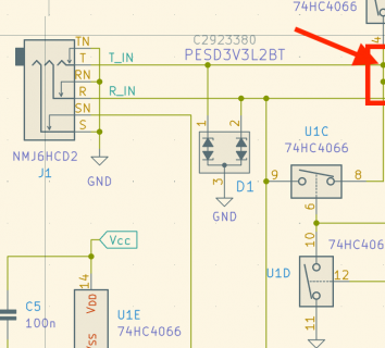

@Pio just a question - I did't even know "dual footswitches" were a thing! Do you mean a single unit functioning with two switches, like this one:
I'm not sure about this - would there then be two switches inside the unit, and in that case, wouldn't they have two different input jacks?
If not, then I assume they would use a stereo jack, but then how would we detect each button press with current schematic? I don't see two circuits for detecting two footswitches...
Sorry; I'm just not understanding what you mean by dual footswitch mode...
Thanks,
Mike

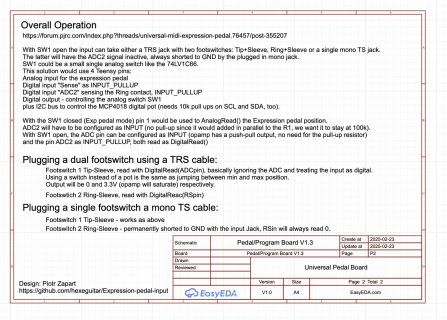

There are dual footswitches with stereo TRS jack output, like the Hotone Ampero FS-1
Making one is also trivial. The dual jack ones would have to use an 2xTS -> TRS adapter.
With the TRctrl signal low:
  1. Plugging a dual footswitch using a TRS cable:
    • Footswitch 1 Tip-Sleeve, read with DigitalRead(ADCpin), basically ignoring the ADC and treating the input as digital. Using a switch instead of a pot is the same as jumping between min and max position. Output will be 0 and 3.3V (opamp will saturate) respectively.
    • Footswtich 2 Ring-Sleeve, read with DigitalReac(RSpin)
  2. Plugging a single footswitch a mono TS cable:
    • Footswitch 1 Tip-Sleeve - works as above
    • Footswitch 2 Ring-Sleeve - permanently shorted to GND with the input Jack, RSin will always read 0.

I can't use a through-hole connector if I place it there due to the metal shell being in the way

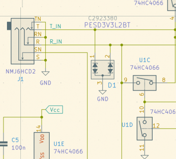

The built in zener diode is rated for 5V, with 3.3V it will work below the reverse breakdown voltage, maybe pulling a tiny current only.
The two pairs of clamping diodes (instead of 2xBAT54S) will work.
I'm trying to use parts available at LCSC, but their parametric search is not the best.
Found the PESD3V3L2BT (C2923380) which is dual ESD protector for 3.3V level. Simpler to use and doesn't need the VCC.

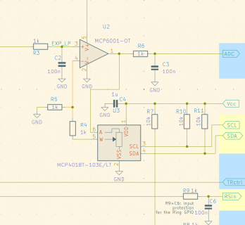

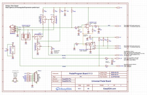

One small thing: according to the simulation the max gain needed when the Expression Pedal pot is 10k is 11x. Right now U1 provides the 11x gain when the digital pot is fully shorted (1+(R4/R5)). In practice the digital pot will have some series resistance, plus there are pot value variations. It would be better to have a small gain margin there to cover all possible situations.
This could be achieved either by increasing the R4 or lowering the value of R5. Aiming at automated assembly, it's better to reuse the values already present in the schematic. Adding 1k in series with R4 (=11k) or adding 10k in parallel to R5 (=0.909R) would rise the max gain to 12x.
I updated my version of the schematic to include an R16 in parallel with R4:
Sorry it's blurry but here's the whole thing again:
I really appreciate your expertise and brilliance @Pio.
I don't know KiCad well enough and I've been using EasyEDA for a couple years, so that's why I've been recreating it each time. And it's well integrated with JLPCB, which I use all the time. Plus I've learned a lot from you, and from the process, just remaking your professional schematics.
If you see any errors please let me know.

Schematic: got last small changes: in the gain setting area I've moved the digital pot to the feedback loop of the opamp. This way the gain control will be linear with the correct range.
Switched all decoupling caps to 0603 1uF to minimize the BOM. No need to chage them if you insist of using C0G 100n.
Html BOM looks compact now, except that single 100k reistor.

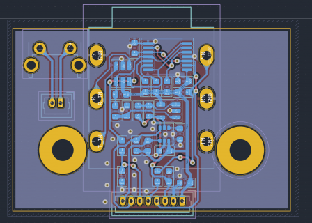

PCB Layout:

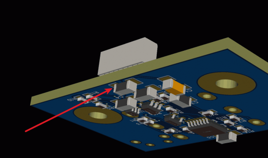

I see the R9 is shorted. It happened because you have put the same net names for the signal before and after R9. Same with R8.

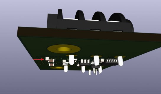

You mentioned not using THT connectors, because the metal shell can be in the way (creating shorts i guess?) The placement of the 1206 caps can cause the same problem:
In my layout i specifically avoided putting any components close to the pcb edge there:
Back to your EasyEda design: top layer is VCC plane. I wouldn't do that, a solid reference ground plane is more important so that all the electromagnetic fields created by the tracks have something to couple to while the currents are trying to find the shortest return path.

I'd prefer if you remove my name from the EasyEda project and link this thread only. You are redoing and adapting it yourself to your needs, you are the author of that particular version.
Ideally now would be the time to test the circuit in hardware, either by breadboarding it partially or ordering a small number of prototype boards.
Hi @Pio, thank you again. Good catch on the net names shorting the resisors; corrected.
I only put your name on because I wanted to give you credit, as you've been so generous, but I understand and have removed your name from the schematics, and kept the link to your repo.
I've also changed to two ground planes, one on each side of the board.
And good catch on the larger caps being in the way; I was so focused on the PCB I quite forgot to check.
I am just reluctant to use X7R caps due to derating, especially in the smaller sizes. That's why I try to stick with C0Gs when I can, although they are not always available in the sizes I want.
Many kind thanks for your support and for proofing the schematic; I'll post another update soon with your suggestions as well as the small tweak to the circuit you just made.

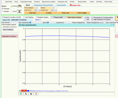

It is not that bad as it sounds. Understanding what the capacitor does and which parameters are critical allows to use the X7Rs without problems. They work in millions of devices.
To test, i've picked up two 0603 caps made by muRata, both available via EasyEda library:
0603 100nF X7R GRM188R71E104KA01D
0603 1uF X7R GRM188R61E105KA12D
There also an AC voltage related capacitance loss, which has to be taken into account. I've set it to the wort case scenario (10mVAC).
1uF will provide about 700nF in the working conditions, which is good enough, including the tolerance.
100n will be slightly less with almost flat linear response over the voltage range. Good enough in the application.
Plots made with

Off the bat, I'm not sure why but I have to set the TCTRL pin to LOW to make the expression pedal work - which is backwards to what I understand the logic to be. I was using the final schematic from before, but here it is again:
It's VERY NOISY! I'm using the analogRead library and had to use some heavy duty settings to get it to work:
analog.setActivityThreshold(12);
Normal value here is 4. The higher the number, the less sensitive the response. I was thinking to add a 1uF and 100nF cap in parallel with the
EXPR_Pedal_ADC1 pin on the board to hopefully absorb and mitigate some of the jitter in hardware, but wow. Not sure why this is the case.
I also used a library for the MCP4018 (the digital pot, U3), which you can find here: https://github.com/Destination-SPACE/DS_MCP4018_Library/tree/main. With quite a bit of fiddling I managed to get full MIDI output 0-127 on this pedal by setting the pot wiper resistance and percent just so (see posted code above for details).
Also the pedal sensing algorithm works great; it gives a message when the pedal is inserted or removed, just once, which is exactly what I wanted.
I haven't yet tested single foot switch or dual foot switch operation yet, but I will do so and post results soon, as well as the software settings I used.
If anyone has any comments or suggestions, they are welcome.
Thanks again @Pio for the wonderful project. I am so excited to finesse this out completely in the software and work out any hardware bugs I may have introduced (or messed up).
