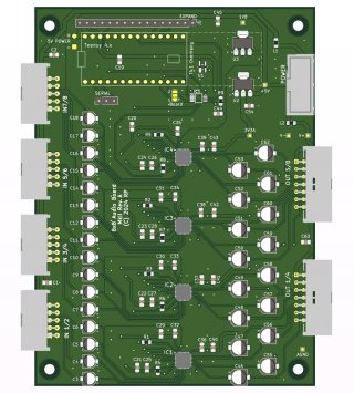

Folks,
With the CS42448 going end of life, I'm updating my 8x8 audio hardware (Audio Toy) and drivers to use multiple TLV320AIC3104 chips (4 per board).
These CODECs pay proper attention to TDM transmission, having settings to enter 256 clocks/frame mode, set the TDM slots used and to allow DOUT to go tri-state when not sending data.
However, the COCDECs require an inverted BCLK, as the data is valid on the falling BCLK edge, rather than the rising edge as for the CS42448.
Is there an easy way to invert the BCLK in the Teensy TDM driver, or should I just invert the signal with hardware?
BTW, the new design allows two boards to be stacked for 16x16 channels and has PGAs that allow direct connection of microphones without preamps.

Progress:
I have populated a Rev A board and have I2C multiplexing working across the four CODECS and am now working on getting the TDM slots properly aligned and enabled for the ADCs and DACs. The programming model for the chip is quite complex (more than 150 writable registers, with some needing to be written in a specific order!) so progress is somewhat tedious on the software side.
Rev B will use a TCA/PCA9544 for I2C multiplexing, as there is a suitably small package available.
Hand soldering the VQFN CODEC chips was a pain, so I'd recommend buying boards with at least these chips assembled - I'll share the full design on JLCPCB when it's done.

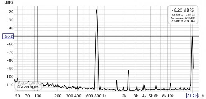

The RevA board is working nicely, however there is an input spike at ~21kHz, the magnitude of which is directly proportional to the signal level (at least for inputs from 0.9 FSD to 0.05 FSD). There is no frequency spike on a sine wave output.
The code was compiled at 600Mhz for the T4.0 using the latest teensyduino.
The spur frequency seems to be a sideband of 1/2Fs as its frequency is 21.025kHz with a primary signal of 1kHz and 21.85kHz with a 200Hz primary. The magnitude of the spike increases with frequency, being 50dB below the fundamental at 200Hz, and 5dB greater than the fundamental at 8kHz, where the spur frequency has moved down to 14.05kHz.
Adding and removing the LRCLK series resistor doesn't change the magnitude, and the frequency isn't exactly half the sample rate, so I doubt if it's crosstalk from LRCLK.
I tried some input filtering (150 ohms/2700pF), but that didn't make any difference to the magnitude of the spur.
The artefact is there and the same magnitude with both single-ended and differential inputs.
There's no active logic else on the PCB, other than the T4.0, the TLV320AIC3104s and a single inverter for BCLK.
Any clues?

That seems to be behaving like aliasing, but having said that I don't know enough about how and where that might arise!
One thing I could and did calculate ... that input filtering with 150R/2700pF has a -3dB point of about 393kHz, so it won't make any difference. I found an online tool, though I only used it to check my hand calculation of 1/(2·pi·R·C) ... promise.
Yes, your calculation of the pole frequency is correct.
CODECs oversample at 128 or 256 times Fs and single pole filters start to roll off at 1/10 of the corner frequency, so an antialiasing filter is usually set at around 10x the maximum desired sample frequency.
I think I actually have a TDM timing issue on the input which is bleeding a bit across two channels or sampling when the data isn't stable. The aliasing artefact doesn't appear if I feed the right channel input instead of the left.
Next test will be to connect the TDM inputs to the outputs and see what comes out!

I'm still narrowing down the aliasing issue, above, which I now suspect is a 3104 register programming issue, as it is only on the R channel across all four devices and only on inputs and not outputs.

The CS42448 uses 32-bit TDM slots and the 3104/3105 chips use 16-bit slots. It appears that the audio library code assumes this and does some 'special' data juggling to put the 32-bit data into alternate audio-library buffer slots.
The relevant (input) code seems to be in the ISR code as the DMA blocks are processed, specifically lines 134-139:
    for (i=0; i < 16; i += 2) {
            uint32_t *dest1 = (uint32_t *)(block_incoming[i]->data);
            uint32_t *dest2 = (uint32_t *)(block_incoming[i+1]->data);
            memcpy_tdm_rx(dest1, dest2, src);
            src++;
The memcpy_tdm_rx( ) code seems to do the actual juggling (lines 94...)
// TODO: needs optimization...
static void memcpy_tdm_rx(uint32_t *dest1, uint32_t *dest2, const uint32_t *src)
    uint32_t i, in1, in2;
    for (i=0; i < AUDIO_BLOCK_SAMPLES/2; i++) {
        in1 = *src;
        in2 = *(src+8);
        src += 16; // was  "src += 8;" prior to jMarsh's response.
        *dest1++ = (in1 >> 16) | (in2 & 0xFFFF0000);
        *dest2++ = (in1 << 16) | (in2 & 0x0000FFFF);
While it appears equivalent (simply processing the samples individually instead of in pairs) this works properly for the 3104.
static void memcpy_tdm_rx_16(uint16_t *dest1, uint16_t *dest2, const uint32_t *src)
    uint32_t i, in1;
    for (i=0; i < AUDIO_BLOCK_SAMPLES; i++) { // 2 samples per word
        in1 = *src;
        *dest1++ = (uint16_t)((in1 >> 16) & 0x0000FFFF);
        *dest2++ = (uint16_t)(in1 & 0x0000FFFF);
        src += 8; // 2 samples per word
...with the appropriate 16-bit destination pointers defined in the ISR
        for (i=0; i < 16; i += 2) { // channel pairs
            uint16_t *dest1 = (uint16_t *)block_incoming[i]->data;
            uint16_t *dest2 = (uint16_t *)block_incoming[i+1]->data;
            memcpy_tdm_rx_16(dest1, dest2, src);
            src++;
Any clues as to why one works and the other produces the weird aliasing described above?
This doesn't look right:
        in1 = *src;
        in2 = *(src+8);
        src += 8;
The same src data is being used twice; first as in2, then as in1 during the next iteration. I think src should be incremented by 16 instead of 8.

You are quite correct, I miscopied a partially edited piece of code from Paul's original version.
It should read.
        in1 = *src;
        in2 = *(src+8);
        src += 16;
I have fixed the original post so as not to confuse others.
The original library is intended to output 16 16-bit samples in each frame: the CS42448 gets its 32-bit samples by dint of the designer only wiring the even-numbered ports on the TDM output object. Purportedly tested by Paul, but maybe not as thoroughly as you!
…hit “post” too soon…
Maybe the omission of the masks for in1 is the issue? Hard to say…
For my multi-output update I had to completely re-write the blocks-to-buffer code, because the interleaving changes with the number of outputs in use. I’d be grateful if you can find time to test it with your hardware at some point, as I don’t have any 16-bit capable codecs.
Argh. Sorry. We’re talking about inputs! Here’s a PR intended to fix an input problem, though it never got merged … it was ignored for 3 years, then the contributor closed it and replaced it with a PR for some totally broken multi-IO code … so I wrote mine, which I believe to be fully working and will submit a PR when a few people have tried it.
