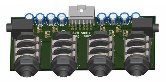

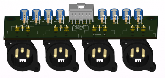

Just curious if your new boards will have all in one xlr/ 1/4" jacks like your previous audio mixer project?
Because the CODECs have high-gain (0-60dB) PGAs and outputs that can source enough current to drive headphones or terminated balanced lines, this design does not need separate preamp or output driver boards. What I have done is made a series of 'wing' boards with different in/out jacks.
The TRS version works as either input or output, with stereo headphone mini jacks on the ends for outputs.
The XLR version has output (F) jacks mounted on the top or input (M) jacks on the bottom (pictured).
I'm considering making everything available either on Tindie or as a Kickstarter. Still to work out PCBA prices for the main board. The bare wing boards will be a few dollars each. I will post the prices here before committing.

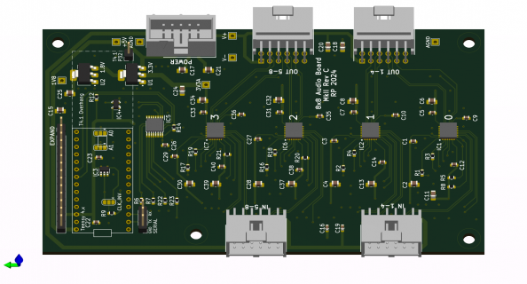

I've now built and tested the V2 prototype and it works and the Teensy Audio driver is in a solid beta state.
  • 8 in, 8 out, USB in and out

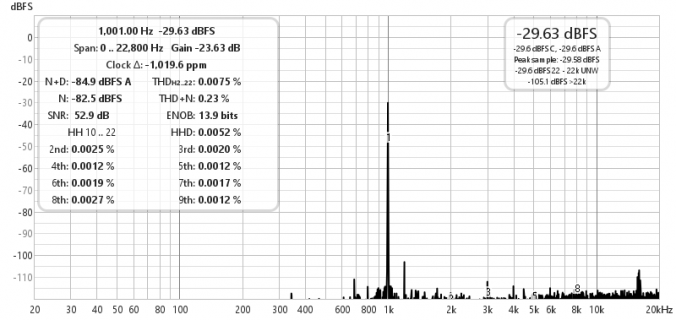

  • 0.002% input distortion with a 10-bit arb function generator. Probably better when I get around to testing with proper audio gear.
  • Balanced or single ended inputs. Up to 60dB (PGA) gain on the inputs - so microphone or line compatible.
  • Able to drive 600 ohm balanced lines directly by using the headphone outputs.
The downside is that the TLV320 chips are a real pain for humans to solder, being QFN (no pins) packages.
After putting the board through the SMD oven cycle, I spent nearly a day getting all the connections to work - with a needle point soldering iron!
I'm going to price PCBA in the next week to see if its economic to do shortish runs (10 or 20 boards). I have a feeling that the international postage will cost more than a board!
The current PCB is moderately large, 75 x 130. Close to 75 dimension is required if a T4.1 is used (e.g., for network audio).
It might be possible to shave a bit off the length by turning the chips 45 degrees.
Are folks more interested in the smallest possible form factor, or getting their hands on some boards ASAP?
I will open source the design and PCB(s) - this PCB is bare Teensy + CODECs, so I have designed a set of 'wing' boards that can accommodate TRS or XLR connectors. I think that's all explained in an earlier post.
Next up, commissioning a second board and trying out 16 x 16 operation!

Your image says rev H in the title, but rev C on the silkscreen…

Very cool! Is the full schematic / layout online anywhere to take a look?
I notice the resistors and caps around the codec chips are pretty spaced out, is that done for any signal integrity reason or just aesthetic?
