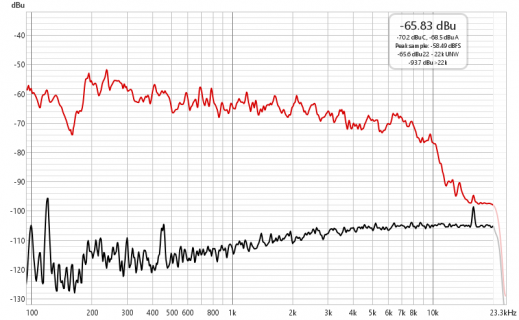

Here's a test with an ancient Electrovoice RE80 that hasn't been dropped too often (despite mainly being used as a bass drum mic).
I've left the audio as recorded - Teensy peak indicators were at about 0.8 at the loudest part.
The red line in the spectrogram is the peak when I counted to 10. The black is just holding the mic. The mic has little treble response, so the drop off is not surprising. It looks like around 55dB S/N at low frequencies, and 40-45 above 3kHz.
So, not as good as a professional preamp, probably good enough for live sound.
Line level inputs are a quite different story. Noise is around -90dB. Distortion is 0.015% (weighted).
