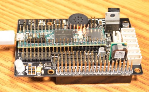

Problem is, the board I did it to is soldered in to a bigger board:
And I was out of stackable headers, so I soldered it directly in :( The OK part of it, is this was the board I figured out that the Audio was wrong, so I ordered new boards, from Digistump, back on the 13th, so not sure how long it will be before I rebuild... Next build I will install headers...
Not sure how hard it would be to unsolder to remove the chip... When I get to that point, my assumption is, it will be a destructive removal. But may be nice to reclaim some of the more expensive parts, like DC to DC converter.

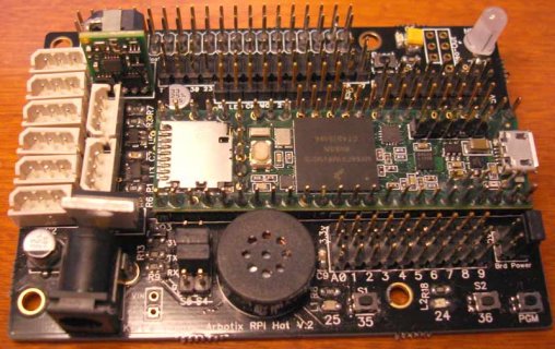

@KurtE - I've got your board on my desk right now. I think I see the problem, but I can't see where traces go underneath the parts. Are gerbers or images of the layout available?
Ok, problem solved. Here you can see it's running the LED blink again. :)

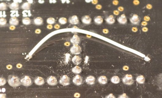

The problem was this 3.3V power trace on the bottom side. It connects to the Program pin!
As you can see in the photo, all I had to do to fix the board was cut this trace away from the Program pin, and solder a wire so it still feeds 3.3V power to where ever it goes. I can't see the traces underneath the Teensy 3.6, so no idea there's more 3.3V connections I severed by doing this.
I've asked Robin to send this back to you tomorrow.

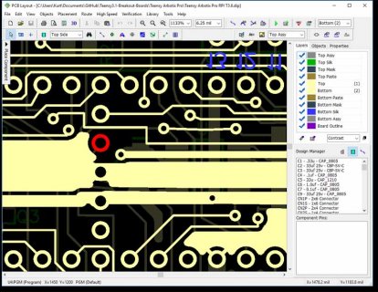

I should have mentioned that the design files and zip file for gerbers are up on github in https://github.com/KurtE/Teensy3.1-Breakout-Boards/tree/master/Teensy Arbotix Pro including zip file: TeensyArbotixProRPIT3.6 Gerber.zip
However I think the current one up there is one for the updated version fixing Audio output issue
It will be interesting to see what connection was made. Maybe I had solder bridge. At least with the current version of the board:
The Pad should not connect. There is GND copper pour that comes close. Maybe I need to check the gerbers to make sure it does not come too close.
I am curious do you typically run your gerbers through a 2ndary review program. Often I use Viewmate to double check things, but may have gotten lazy on this one...
On the Other side of the board, the pin connects to etch which then simply runs to a NO button, where the other side of the button is GND.
It was shorted to 3.3V, not GND.
I almost always look them over with gerbv.
