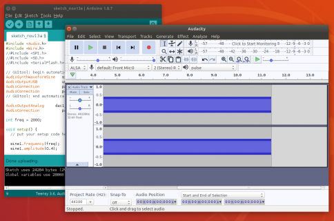

I tried it just now, but could not reproduce the problem.
I ran it with Ubuntu 18.04.1, Linux kernel 4.15.0-38-generic.
To test, I uploaded the code from msg #44 to a Teensy 3.6. I set Tools > USB Type to Audio. All other settings were at defaults.
Then I opened Audacity and clicked the red record button. It defaulted to recording from the Teensy, probably because it was the most recently added USB audio device. I didn't click *anything* else in Audacity, only the red record button. I let it record about 10 seconds before I clicked the stop button.
When I clicked play, I got no sound. My guess is it was defaulting to try playing through the Teensy.
I unplugged the Teensy and clicked play again. I did not click *anything* else in Audacity. This time, with the Teensy gone, it played through my computer's speakers. I heard the shrill sound of the 2 kHz sine wave. Other than the start and stop, I do not hear any clicking, popping or other strange sounds. It's just a continuous unpleasant-to-listen high pitch sine wave.
Here's a screenshot.
Normally I try to document my testing more thoroughly, but I just don't have time to set up a mic in the room and make a good recording and video of the test. Need to get back to work on T4. Annoying as the sine wave is to hear, best I can tell you is I did play the whole ~11 seconds a few times with my speaker volume turned up (a rather unpleasant listening test) and I could not hear any clicks or other odd noises. I did the listening test using Behringer MS40 speakers connected to my PC's optical SPDIF port, so if there were defects in the sound I'm pretty sure I would be able to hear them with this test.

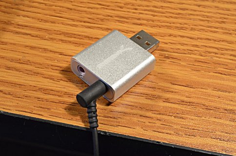

I ran one more quick listening test, using this cheap USB audio adaptor and good quality Bose AE2 headphones.
Again, Audacity played back the sine wave without any strange clicking noises, except a slight pop at the beginning as the audio output turned on (so easy to hear tiny imperfections with these over-ear headphones). I must admit, I didn't manage to keep the headphones directly on my ears for the entire 11 seconds! It's quite a shrill tone.
Here's what the kernel says in syslog about that no-name USB audio adaptor.
Nov 13 17:29:10 preston kernel: [1119464.773678] usb 4-13.4: New USB device found, idVendor=0d8c, idProduct=0014
Nov 13 17:29:10 preston kernel: [1119464.773686] usb 4-13.4: New USB device strings: Mfr=1, Product=2, SerialNumber=0
Nov 13 17:29:10 preston kernel: [1119464.773692] usb 4-13.4: Product: USB Audio Device
Nov 13 17:29:10 preston kernel: [1119464.773696] usb 4-13.4: Manufacturer: C-Media Electronics Inc.
The printing on the top says "Sabrent". I believe it might be this product, but honestly I have no more info about it.

Paul....... I assume in your quick listening test you Powered Teensy separately by 5V line and plugged USN audio adaptor in to the USB port on Teensy board and listened to audio from the speakers via the lineout of the USB audio adaptor.
I am unable to open the attachment 15150...???
Your kernel syslog.....did you just plug USB audio adaptor into usb port on PC to see what it reads..... not part of the test to test teensy USB audio out.
