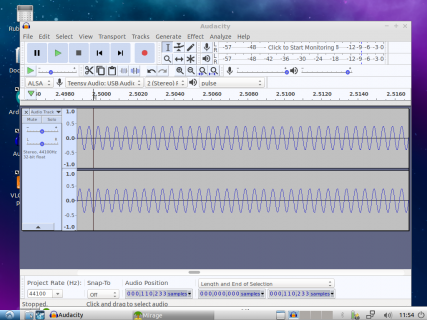

Paul...... I tried again following you test procedure on Lubuntu 18.04 and still get the faint clicks. I have attached screen dumps and an audio wav recording.
I am not sure that your test with the cheap USB audio adaptor is same as what I was thinking. I am not querying the quality of the playback from the PC, I was thinking of the USB audio adaptor as an alternative to recording on PC and playing back from PC ...... to try and eliminate any issues I may have on my PC because of old hardware.
The way I would intend to test with the USB adaptor is to plug teensy into the USB port of the USB audio adaptor and connect a speaker/amplifier to the lineout of the USB audio adaptor and listen directly without using a PC.
But I don't have one yet to try. I also see you are testing on a teensy 3.6 ..... I am using a Teensy 3.2.....is there likely to be any difference in the audio processing.?? ....... I will order one of these as well.... have about 6 of 3.2's but no 3.6s.
Eventually my use for all of this would be to be able to send USB audio and USB power over 1 lead from a teensy controlled gadget to a USB audio input speaker or other USB audio processing device and not needing an 3.5mm jack

Regards, then sending and recording to a PC, I discovered that if I set the sine frequency to 1000Hz I do not hear any clicks, at 1200Hz the clicks start to be heard faintly and similar at 800Hz the start to be heard faintly. The clicks are louder or heard more easily with higher frequency. at 4000 Hx the clicks are quite distinct. I reduced the amplitude of a 4000Hz sine to 0.01 and recorded this and the audio as well as the clicks were reduced to low 0.01 amplitude. I amplified this in Audacity and 4000Hz audio and clicks can be heard. So does that mean the clicks are coming in with the audio and not being generated in the PC audio processing...???. I have attached audio recording of the sounds.

Yes, I have tried again on Lubuntu laptop and on XP desktop and win 10 laptop and clicking is still there. If I compile on one and play on another, still clicks.
I listened to the 1000 Hz and 1200Hz and 2000Hz that I posted earlier, on both XP and Lubuntu with the same headphones each time turned up same loudness and clicks are there in the 1000Hz as well, I think it was masked more when listening earlier on laptop speakers not so loud and I thought clicks wern't there at 1000Hz.
I can also listen without the need to record and playback on XP by clicking "Click to Monitor" in Audacity and the clicks are still there. Also same with Win 10 in sound settings can click the tick box to listen to Teensy input device without recording and still get clicks.

Using the AudioTiming lib: See above. setI2S_freq(44099.7); Or try without.
It would be interesting to hear if this works for you - or not. I only tested it with WIN10, "live" with speakers. Audacity went on strike and didn't want to record (why...?).
Most likely there is still a lot to improve on this workaround.
