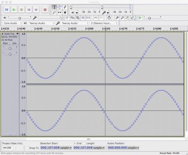

I'm sorry to keep bringing up problems. I know this is just alpha code.
When streaming directly from USB to the Teensy, I was hearing a small distortion so I connected USB-to-USB and observed a problem. This is my code:
AudioOutputI2S           out1; // if I don't have this, it won't work at all. Bug or feature?
AudioOutputUSB           usbout;
AudioInputUSB            usbin;
AudioConnection          patchCord3(usbin, 0, usbout, 0);
AudioConnection          patchCord4(usbin, 1, usbout, 1);
  AudioMemory(12);

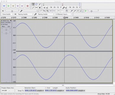

I played a 400 Hz sine wave on the computer. I recorded it in Audacity. As you can see it appears that odd/even samples are swapped:
Looking at the code, I think the culprit is copy_to_buffers() in usb_audio.cpp. It's hard for me to follow the code well enough to catch the bug, but I just rewrote it to:
static void copy_to_buffers(const uint32_t *src, int16_t *left, int16_t *right, unsigned int len)
        int16_t *data = (int16_t*)src;
        while(len--) {
                *left++ = *data++;
                *right++ = *data++;
And now the output sounds fine and looks good on Audacity:

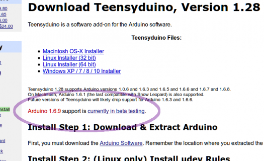

Step one: get something to compile against cores from github.com/PaulStoffregen/cores
I want to start working with this, but I'm confounded by the arduino IDE - I can't get it to compile any examples against the github version of cores/ (I cloned from Paul's repo, the stock teensyduino stuff does fine). It uses Documents/Arduino/libraries/Audio for library includes (Audio.h), where I've put the versions of Audio/ that I cloned from Paul's github repo, but not the version of cores with all the USB Audio goodness. The compile output tells me it finds and uses Documents/Arduino/libraries/Audio, but it still isn't getting the correct headers/source files from cores which I don't really know where to put - I tried replacing it in the arduino.app directory to no avail, and no surprise, and also tried putting it in Documents/Arduino/libraries/cores. It's telling me

EDIT: these steps are no longer necessary. 1.29-beta2 has all this stuff built in.
To try this very early code, before a beta test installer is published, you're going to have to edit stuff within your copy of Arduino.
On a Mac, control-click Arduino and choose "Show Package Contents" from the popup menu. On Linux and Windows it's a normal folder, but on Mac it's a special "application bundle" folder, so you have to do this step to gain access.
Once inside, navigate to Contents/Java/hardware/teensy/avr (on Linux & Windows, it's just hardware/teensy/avr). There you'll find a "cores" folder, which is the core library. You need to replace that with the code lib from github.
https://github.com/PaulStoffregen/cores
You'll also find boards.txt, which configures how Arduino uses all this stuff. You can add 3 lines to enable audio, as previously mentioned in this thread. Or just replace it with this copy, which also enables the other new combinations and the not-yet-implemented touchscreen (which wouldn't work with OSX anyway, since Apple doesn't believe in touchscreens outside of phones & tablets).
While you're poking around in there, you'll notice a libraries folder. If you put the Audio library from github inside that folder, instead of Documents/Arduino/libraries, then it will only be used with this one copy of Arduino. If you do leave the experimental code in Documents, later remember to clean it up, so you're not forever stuck with this version.

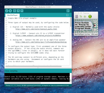

Thanks Paul, the boards file was the key. I saw those 3 lines, but since Frank B said it caused some errors it didn't stick in my mind as something to try.
I'm totally unfamiliar with the arduino IDE (I'm a text editor and make file oriented person), so it took me quite a while of digging in menus and settings, but it works now. Thanks!

Perhaps you could also try with Arduino 1.6.9 and Teensyduino 1.29-beta2. This newer beta version does indeed support Arduino 1.6.9. On the normal download page, it's linked next to "Arduino 1.6.9" in red text.
Hi Paul,
perhaps I am missing something,
my arduino app is an the application folder.
I installed arduino 1.6.9 (dragged into the application folder).
Then I runned Teensyduino .dmg and choose the arduino folder to install it. (the new beta test one)
Then the audio master files are in files folder >arduino> librairies > audio master.
I runned once arduino app.
Then I replaced in the arduino ide as you said to do, the boards.txt file and the core files.
Finally, I lunch once more arduino ide, try wavefileplayer : it works
I tried next wavefileplayerUSB : and here this error ... :
Arduino : 1.6.9 (Mac OS X), TD: 1.29-beta2, Carte : "Teensy 3.2 / 3.1, Serial, 96 MHz optimized (overclock), French"

Skip this step! It's no longer necessary with 1.29-beta2.
Just install 1.29-beta2 with Arduino 1.6.9 and you have the very latest code.
