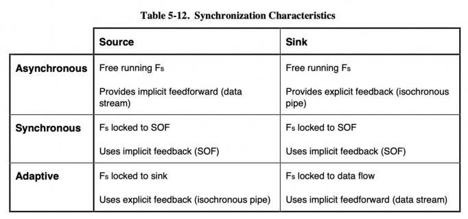

Looking at these two bits of information from the USB 2.0 Spec:
Adaptive source endpoints produce data at a rate that is controlled by the data sink. The sink provides feedback (refer to Section 5.12.4.2) to the source, which allows the source to know the desired data rate of the sink. For adaptive sink endpoints, the data rate information is embedded in the data stream. The average number of samples received during a certain averaging time determines the instantaneous data rate. If this number changes during operation, the data rate is adjusted accordingly.
I don't know why they have to word things so unclearly, but it seems like in the Adaptive case the Teensy *could* be receiving feedback and adjusting its datarate accordingly (resampling or adjusting a clock, presumably) and is not? It's unclear from reading this quickly whether the sink (the PC in this case) is then expected to resample on its side if the source does not.

I don't think there's anything the Teensy is doing to sync to the PC for the Adaptive / AudioInputUSB Endpoint - if it could, then you'd expect USB to be capable of update responsibility, and it's clearly documented as not being so. Plus there would be a need to sync audio adaptors and such to the USB, which would be fairly horrible! So as you've speculated elsewhere, possibly Adaptive is the wrong choice and both should be Asynchronous, with the PC being responsible for re-sampling as needed. That would appear to be the better design choice, as the PC has a lot more grunt.

Yes sorry, by "could" i meant that according to the USB specification, the Teensy has the *option* of reacting to explicit sink feedback, but is not currently. Strangely, grepping for uses of "usb_audio_sync_feedback", that variable is modified in tx_event() but never used, which indicates that maybe some adaptive efforts were a work-in-progress?

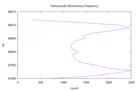

Don't know if this is interesting, but I left my Teensy on overnight playing audio from my Linux host, and logged the ALSA "Momentary Frequency" (the observed sample rate based on the datarate from the Teensy) every 300ms, and this is what the reported samplerate looks like as it drifts back/forth from the target 48000Hz samplerate I'm using:

I definitely see (relative) clock drift, the glitches tend to start out every ~30s at the beginning of the day, and get slightly more frequent as time goes on. That is an interesting graph, and strongly suggests the feedback calculation needs a good seeing-to; I think it's been commented on somewhere previous in this thread (yes, posts #21 to #25) ... can you tell where / when the audible glitches occur, relative to the observed sample rate at the time?

While I observe that drift there were no underflows or overflows, so the feedback code works but could maybe be improved to not allow that slow drift (one "period" between 47990 and 48010 was on the order of 60 seconds at 48kHz). It's worth noting that I also did experience over/underflows when I used the default buffer size of 128, and had to increase it to 256 to stop seeing them. This could be reduced again if the feedback code allows for left drift, however.

I left the teensy on overnight at 8x 96kHz 16bit and no over/under runs and a relatively stable Momentary Frequency hovering around 96001 and 96002Hz. I also added some experimental code to have a "flood gate" that won't report or react to underflows until the first "ready" buffer is... ready.
