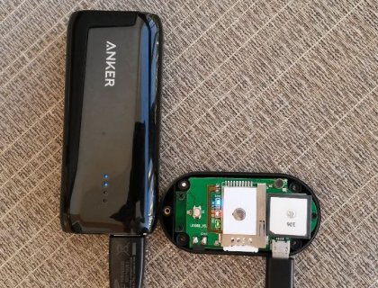

I have a GPS tracker that has a internal battery that could last for 3 days on normal operation. I will like to extend the battery life on the tracker since it will be on the field for several days. This small GPS tracker can be charged by connecting a regular 5v cell phone charger on its micro-usb in this case a Power Bank as you may see on this picture.
The problem I have is that as soon the internal battery its fully charged the battery bank turns it self OFF. The only way to turn the Battery Bank ON again its by removing the USB cable and plugging it back OR pressing a small button on the BBank. I have found a link on dorkbotpdx website http://www.dorkbotpdx.org/blog/paul/battery_pack_load that shows a way to prevent a battery bank to shut it self OFF when little power is consumed. I appreciate the time of Paul Stoffregen on sharing his diagram.
The model of this battery bank is Astro E1 5200mah. I wrote the manufacturer about the Auto Shut OFF and this is what they answer me
The Astro E1 you bought has minimum current requirement 30mA~70mA. That means if the output current is below this range, then, the battery won't work.
Since I'm no expert on electronics I will like to ask for advice. Does placing this circuit between the BBank and GPS Tracker will prevent the BBank to shut it self OFF? I know there will be power loss in the long run but at least the GPS tracker will have more days of work rather than using the internal battery.

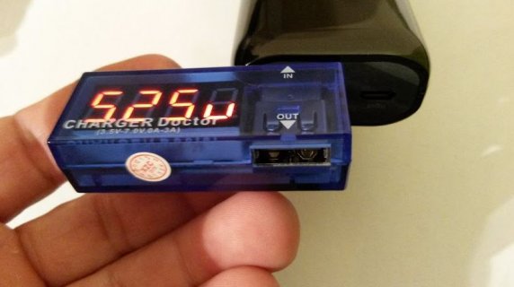

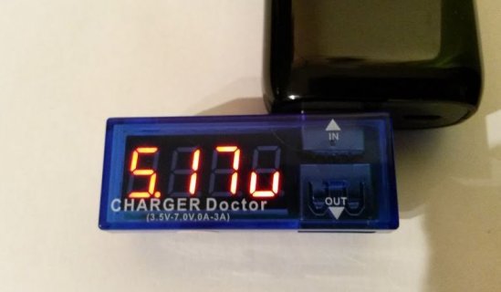

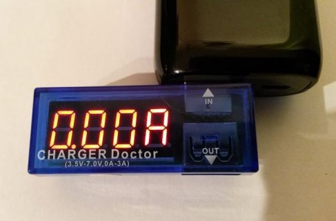

Thanks all! Its overwhelming getting so many points of views. I test this battery bank and saw it turn it self Off after 15 sec of inactivity. I also got today on my mail this little usb meter. My idea was to connect the "charger doctor device" and it will basically could tell the battery something was connected even if the GPS in the other end was fully charged. At least the battery will stay ON. Seems it do not consume the minimum of 30ma that the manufacturer recommends to leave the BBank ON. Do you think there is a way to modify this little gadget? It only cost me $1.50 us

That's just a meter displaying current draw, and would have been designed to draw the minimum current so not going to help overmuch keeping the battery bank active. It's not going to have any smarts in it so not much to modify, though case is a handy size if you do go for the 'pulsed draw' method.

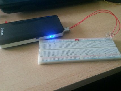

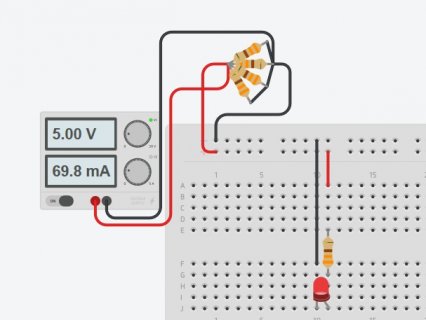

Hello guys. I was searching for information because my power bank was closing down when I use it with a breadbord and basic circuits. And this thread is always on top. So I thought it maybe useful for people. What I did was to keep powerbank see there's a mA value bigger than 50. This is the limit. If you cant reach that it shuts itself down.

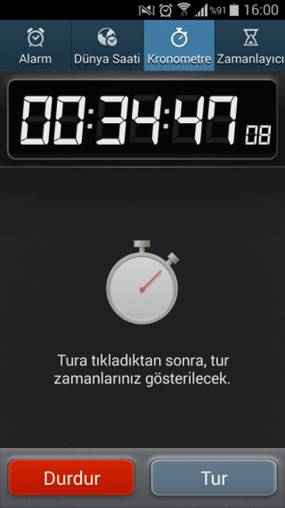

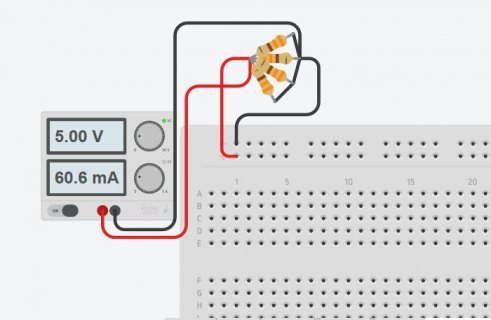

I used circuits.io to make a simple way to pass that limit with what I have in my hands and simulate its mA level. So I used 4 x 330ohm resistors to get 50+ mA. Tested it for 30 minutes and it didn't shut down. For your battery issue you may need to find a way to add these resistors at the beginning. And I'm not sure if its safe to force a battery to overload. But this is the circuit...
I don't know much about resistors. So they may heat up but It looks fine so far.
blackleon, your circuit works, the design posted above trades increased complexity for lower wasted power by only pulsing having the resistors in circuit for short periods, given anything going into the resistors is wasted in terms of maximising battery life.
