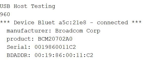

Hello. I have a BT dongle. I've been looking throughout the forum and the many USBHost_t36 samples for the code that will allow the BT dongle to get in pairing mode. One of the samples, Digitizer, allowed me to verify the BT is connected. This is how far i got. BTConnected.JPG. I have a T3.6, and a Rev C audio board. My final goal is to send out Audio from a Cell Phone to the Teensy.. Can I please, get the help to get the dongle in pairing mode?

Thanks very kindly. I wrote some code but i can't get pass a complete pairing. I modify the code below so many times that I am the point right now of guessing, which that's why I need some help. Also, when compiling the file do I need to change Tools>USB Type>Serial to Tools>USB Type (something else). ? Thanks again

I bought three different dongles from the suggested ones from that particular thread. All three dongles showed connected.
After uncommenting Debug Line, message appeared "ResolveLibrary(debug_tt.h)rduino\BTPairing\BTPairing.ino:7:22: fatal error: debug_tt.h: No such file or directory"
I didn't mention it on my previous reply that after uncommenting the last IF on my code, the message "'class BluetoothController' has no member named 'PS3Pair'" showed up
