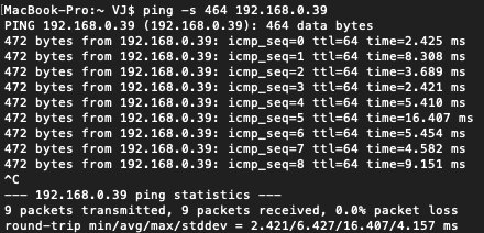

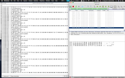

Based on the suggestion by Defragster, here's a new thread for the efforts going towards getting a driver going for USB to Ethernet adapters.
My own example can be found here: TeensyASIXEthernet
It's based on the ASIX AX88772B chipset although it may work for other ASIX chipsets.
Any help that can be offered would be greatly appreciated because I know this can turn into something that could be pretty useful.
Basic testing shows this is receiving messages and can also transmit messages so it's at least a start.
