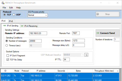

I'm not sure, mine connects fine. Try unplugging and replugging the cable while it's already on, that resets the DHCP request.
0:2:11.262 Tx Tcp 192.168.0.23 47.913 12,720,000 2,123.869
// Closed PING after stating this run
0:4:43.261 Tx Tcp 192.168.0.23 86.506 25,440,000 2,352.680
Benchmark results:
Megabytes: 12
Bytes: 720000
Seconds: 48.0540
Bytes/Sec: 14983.1440
KBytes/Sec: 14.9831
Benchmark results:
Megabytes: 25
Bytes: 440000
Seconds: 86.6400
Bytes/Sec: 5078.4857
KBytes/Sec: 5.0785
