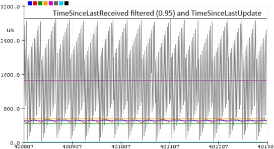

So I did some reworking of Alex's code.
At this time I don't precisely know how the rest of the code runs. I just worked on the filtering part and did testing.
Changes:
  • I removed the whole LastCall from the code and replaced it with an exponential moving average (aka: now=before*weight+now*(1-weight)). Before, the filtering was done on the increasing and overflowing time, but I rewrote it so that filtering is performed on durations, which was simpler and made more sense. I made it so that I can set different filter weights for last Received and last Updated durations.
  • I identified a 'rush' condition in USBAudioInInterface::update, where I believe that an interrupt could be called between the time of uint32_t clockCount = ARM_DWT_CYCCNT; and the calculations for lastCallReceiveIsr ... an update of lastCallReceive could come up, making it more recent than _lastCallUpdate -> causing an underflow and therefore an outlier in the calculated times since last call. I believe this is part of the reason for the filtering and particularly the outlier detection before. I noticed this after instrumenting the code. This was after already reworking a lot of the code, but I believe it was an issue in the code already. So I fixed it in my code by shifting it under disable_irq and I don't detect it anymore. Before it would take tens of seconds for it to occur, now I can't detect it after 20+min.
I am attaching examples of the instrumented raw and filtered "time since" plots.
My rework seems to run ok. I tested for varying weights, but it seems to run even with no filtering (using the most recent value).
I am also attaching the plots of REQUEST_FRREQ over time (when playing 2ch, 44.1kHz, teensy audio adapter, 128 samples). I forget the actual plotting period (It took minutes to form each graph), but all graphs had the same plotting period.
For some reason the code before would sometimes start REQUEST_FRREQ low. But only after uploading the code and running for the first time. Otherwise it would start normally... I didn't come across this with my changes.
Observations:
  • Smoothing TimeSinceLastReceived makes the REQUEST_FRREQ jagged! It is better raw = most recent!
  • I didn't see an effect when smoothing timeSinceLastUpdate.
  • I think buffers were fine
The max processing time using my code has gone down from 3.2+% to 0.16% (original Paul's implementation ~0.12%). This is with or without filtering as it is a very simple calculation. I didn't actually pay a lot of attention to optimization.
I am just about able to handle ADC as well (at 600MHz setting).
@alex6679 let me know if you would like me to share the code. You can also play with weights.

Hi, thanks for investigating the code.
Some remarks from my side:
Just filtering the time doesn't make sense of course. At my first attempts I also filtered durations. Back then I used a second order filter instead of a exponential smoothing. But in the end the question is: How to get an accurate time from a filtered duration? Also, it didn't work that well at suppressing outliers (I describe below, what I mean by outlier).
I tried to keep the section at which isrs are disabled as short as possible. In principle it shouldn't be a problem if the 'usb samples receive'- interrupt is called shortly after the time in update is measured. In that case the smoothed number of samples in the buffer should automatically be decreased (lastCallReceiveIsr > updateCurrentSmooth). But maybe there is a bug in the code. I'll have a look at that.
In general: I introduced the outlier detection because sometimes there are interrupts with a higher priority than 'update' or 'usb_audio_receive_callback'. Normally e.g. update is called every 2.9ms. If a higher priority isr is called just before update, then this update call is a bit later/ is an outlier. Then the algorithm computes too many samples for the smoothed buffer.
@moti7j If you share your code, I would have a closer look at it and test it.

I think I should have explained how the LastCall algorithm works before you started your evaluation. Unfortunately, I’m currently very busy and didn’t manage to find the time during the week.
Regarding the smoothing of durations and times:
I don’t think that smoothing or applying a low-pass filter to the timestamps at which, for example, the update or transmit interrupts are called makes sense, since these times should (obviously) increase linearly. It also doesn’t help to filter the duration between the transmit ISR and the update calls, because we don’t expect that duration to be constant. We expect it to look like a sawtooth signal.
At first, I tried filtering the duration between the update and the transmit ISR calls, because that duration should always be constant. However, these attempts weren’t very successful. In the end, I implemented the LastCall algorithm, which works a bit differently:
  1. We know the expected duration between the update calls (~2.9 ms), and we can use it to generate a “perfect” time sequence:
    0 ms, 1 × 2.9 ms, 2 × 2.9 ms, …, N × 2.9 ms.
  2. We then fit this perfect sequence to the last N samples of the measured sequence. Fitting is quite simple here: we just align the centers of mass of both sequences.
  3. Next, we remove outliers—i.e., the measured samples that deviate the most from the fitted perfect sequence.
  4. We perform a second fit, this time excluding the outliers and the corresponding samples of the perfect sequence.
  5. Finally, we use the latest sample of the perfect/fitted sequence as the time of the last update call.
This approach is quite different from simply filtering the calls.
Let’s assume there is no noise and no outliers in the time sequence of update calls. The LastCall algorithm would then simply return the measured time of the last call.
If we just apply exponential smoothing, the result is always too far in the past:
smooth_val = smooth_val * weight + new_val * (1 - weight) < new_val
Also, applying a low-pass filter to the duration between the update and transmit ISR calls does not help either. It would just smooth out the expected sawtooth signal.
Anyway, I should revisit the algorithm. Your “before” plot of the current algorithm looks a bit strange. Also, there’s definitely room to improve the algorithm’s performance and make it faster.
Maybe it’s more efficient to work directly with the duration between the update and transmit ISR calls, as you suggested. Instead of using a standard low-pass filter, we could, for example, fit a linear function to the unwrapped sawtooth signal. Or, without unwrapping, we could fit a sawtooth function directly to the signal. Based on the expected durations between consecutive interrupt calls, we already know what this sawtooth should look like and we just need to find the time offset.
What do you think about that idea?

I ended up only trying to replace the processing bottleneck.
It seemed to me that the LastCall aligning the centers of mass is effectively filtering with a rolling average, but compensating for the introduced lag of such averaging by effectively doing the filtering on the centers of mass.
There are places that use getLastCall<2> which to me seemed like minimal filtering? or was this just for outlier detection?
It seemed to me that the smooth time is used only for the calculation of durations, which would effectively mean that the durations are filtered. I thought that this was being done to get a filtered reqested frequency, so it felt to me that it might need to be smooth, but I think I might be wrong here. If you give me some more pointers I might be able to better understand how these durations are used.
I understand that some variability of times/durations might be introduced by other interrupts, but I don't realy understand if those should be filtered out. If yes, would it make more sense to make predictions based on previous buffers - nr. of samples and not time durations? Again, appologies, I don't fully understand it all.
If it helps, I will say though that from my practical testing the audio was still stable despite some (undesirable) filtering being applied. So to me it indicates that it is perhaps not very sensitive to variations.
I am still experiencing issues with WASAPI that I don't experience otherwise. But only when ran in exclusive mode. I'll write it up, hopefully tomorrow.
I was expecting the usb callbacks to be called every 1ms and the updates every 128/44100=2.9ms, so I was expecting ~3 steps in the saw tooth plot, but there are more!? So that is why I say I don't fully understand it all.
I didn't have a look at the code, but is the function we see in the saw tooth plot a downsampled/ aliased version of the original saw tooth? That would explain your observation.
That might be. Since it depends on the host and we can't test it for all hosts, I would still try to get an as-good-as-possible estimation of the currently buffered samples and thereby a smooth/ accurate feedback to the host.
Also, I don't know how the varying requested frequency is handled by the host. I guess in some cases the signal is resampled to match the currently requested frequency. In that case the higher the the variation of the feedback is the more distorted the signal gets. We therefore want to keep the feedback as stable as possible.
Maybe you can focus on the WASAPI problem and I can try to make filtering of the duration/ the stuff in the LasCall class more efficient?
The sampling should be 1ms, so not aliased. Having a second look I see the 3 steps in the saw tooth (the rapid one), but I still have to better understand the second saw rate. I will try to find time to understand it.
I tried a lot of things with WASAPI but I keep getting choppy data and I am a bit lost :(
