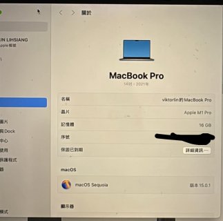

Big thanks to @alex6679 for all the helps, we have met twice for last two saturdays, unfortunately we still could not spot the reason why my Mac could not work with teensy 4.1 for USB multi-channels. In the beginning I was on OS Ventura (13.x.x) and then updated to Sequoia (15.0.1).
I am posting the screenshots of the spec of my USB and Mac OS here for further debugging and really looking for mac users who can share their experience if they have made it work. cheers.
View attachment 36078View attachment 36079
Hi hi this is my Mac spec i posted.

That’s kind of good news, though it doesn’t help us pin down what the heck is happening to @Weiweiweiwear :confused: But thank you for taking the time, it does show that 6/7 of Macs are OK!
Could I plead with you to try and find out the Apple product code for each of the machines you tried? My iPhone 13, for example, is Model Number FLQ63B/A, as found in Settings/General/About, or A2633 if I tap on the model number. My iPad is A2072 (in very small text on the back…) or FYH62B/A. If nothing else, it’ll reassure people with that exact model that the code should work for them, and also mean we don’t necessarily need anyone else to test those models again, unless they have a different MacOS version on them.

good to hear that! but I did the test with @alex6679 via video chat step by step with his code so it’s very unlikely I did something wrong there. And back then it was not only not working on my MacBook Pro but also not on another Mac Book Pro of my friends, that’s why I thought it’s helpless, attached photo is the spec of his mac.
