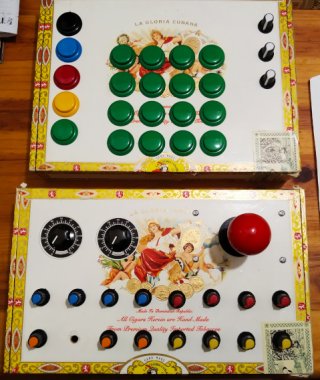

Hi everyone, i’m a social worker and i’m doing music creation workshops for persons with special needs.
I have an Ipad with a bunch of apps, a cheap audio interface, some piezos and we are jamming and recording with that.
I’d like them to be able to record samples, to make their own beats live, and to control some effects
but the center i’m working for don’t have any budget for that, so i have to go D.I.Y.
I already had a Teensy ++2.0 and some cigar boxes, i bought another Teensy 3.5 some arcade buttons and knobs and here is the result.
https://photos.app.goo.gl/qujKW2ST2joHimFR9
Now i’m trying to write the code.
Disclaimer: i’m kind of a noob. My first attempt with Teensy is a midi foot controller that works well but the code was totally borrowed from the examples. I just adapted it to my switch number and so they give CCs instead of notes.
So i took the Many_Buttons_Knobs from the examples and tried it with the Teensy 3.5 with just one button and one knob to see i could get it work like that at first.
And it doesn’t.
The button is not recognized by my app and when i’m assigning the knobs, the value 'floats' and gives glitchy readings like in this thread:
https://forum.pjrc.com/threads/48200-Teensy-3-5-Exemple-AnalogControlChange-Problems
Here is the code*:
Here are my connections on breadboard:
https://photos.app.goo.gl/AFBu59C7C8tHgCmu7
I don’t get what i’m doing wrong.
Also i would like the digital pins to "give" CCs as the analog pins and not Notes and i really don't have a clue on how to do that. I tried to move things in the code that seems to be logical to me without really understanding it but all i got was a bunch of errors .
Thanks a lot in advance for your patience and your help.
