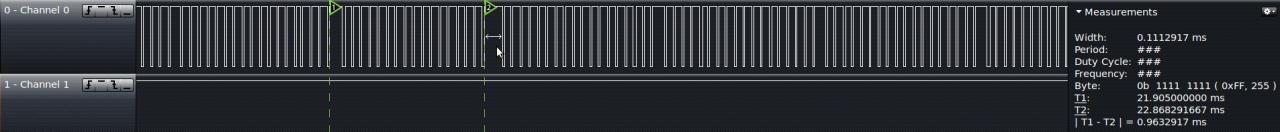

Measured a duty cycle of ~79.5% on pin three. This seems to exceed the actual speed of the serial port? :O That's pretty amazing.
Every 19th high pulse seems to be longer than the others. I'm not sure what caused this though, this periodic behaviour was not seen in my measurement results. (See attachment)
Those are the USB start-of-frame events. Near the end of each frame, the host controller allows the USB line to become idle so it can send the SOF packet at precisely 1 ms intervals. During that time, Teensy 3.0 is just waiting more more data to arrive, so pin 3 is high longer.
