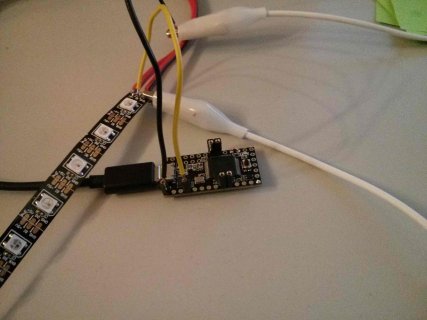

Wiring:
Black cable is ground, connected to the LED strip ground via the white cable (is connected anyways because i use the psu of the same computer the teensy is connected to).
