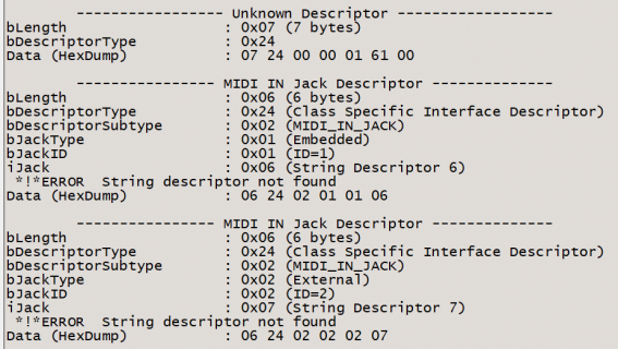

We have a USB MIDI device called OXI One that is failing on the USB host. We used a Teensy 3.6 with a powered USB hub, as the device needs 500mA and is USB powered. To eliminate our code, we used the InputFucntions example to test it and captured some debug output. We also tested with a different MIDI controller which works. We hacked midi.cpp and got it working, but its probably a dangerous hack, see below.

Notice the iJack descriptors are conspicuously missing, which we see with the working controller. The working controller has iJack: 0x00.
Looking at USBTreeView output under Windows, I can see a couple of potential issues that Windows is ok with, but the Teensy host code might not tolerate. Perhaps being more forgiving of this misbehavior would enhance the host code? We suspect it is the iJack string descriptor error.
USBTreeView
We were able to hack midi.cpp, forcing "ismidi" to true and got OXI MIDI to work, but this would probably has some undesirable consequences.
println("    Unknown MIDI CS_INTERFACE descriptor!");
//return false; // unknown
ismidi = true;
Hopefully someone can help us create a workable solution, with the goal of having the host enumeration code being a little more tolerant to bad actors such as this.
Thanks!
There's also an "unknow descriptor" on the USB Device View screen shot above, 0x24. Apparently its typically used on cell phones for mic and speaker select.
The root cause of the failure was found to be the "unknown descriptor" above. The descriptor is recognized as 0x24 = Audio CS_INTERFACE but the subtype is 0x00. Valid types are 1, 2, 3 or 4, and a couple of special cases for Yamaha and Roland. We added a case to the subtype parser in midi.cpp to verify it was bailing on the missing subtype. Hopefully the vendor of the device can fix it, but we're also going to change the parser to ignore bad data since it works fine we do (fingers crossed).
