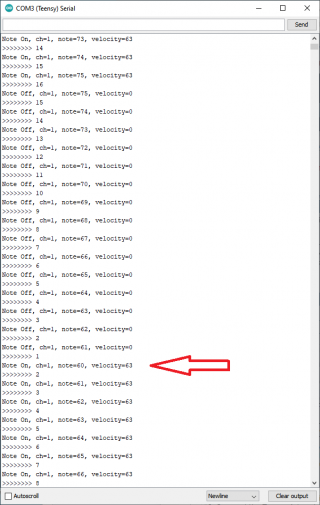

What I did:
1. Uninstalled the complete Arduino IDE.
2. Deleted the ../Arduino15 directory.
3. Reinstalled Arduino 1.8.19 & Teensyduino 1.58. Updated midi.cpp in C:\Program Files (x86)\Arduino\hardware\teensy\avr\libraries\USBHost_t36.
4. Recompiled and uploaded the sketch from message #13 to the Teensy 4.1 [at 600 MHz & USB type Serial].
5. Connected the Arturia controller to the USB Host port & opened the serial monitor.
6. Slammed 12 keys at the same time on the Arturia > fail: (did not even manipulate the mod wheel...).
![Serial monitor.png Serial monitor.png](https://forum.pjrc.com/data/attachments/28/28319-164bf22a0e121ddf1a6b194c753c5da5.jpg)

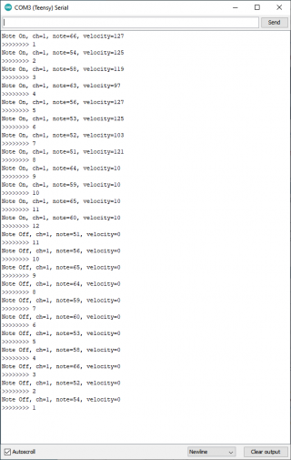

7. Unpowered the Teensy 4.1, disconnected the Arturia and connected the Teensy 4.0-based Arturia emulator [running the code of message #41].
8. Powered the Teensy 4.1 and watched the serial monitor > fail at the red arrow:
![Serial monitor 2.png Serial monitor 2.png](https://forum.pjrc.com/data/attachments/28/28320-d2a099704769c3bbb3da5dd0a5d3fe27.jpg)
Expected Note Off, ch=1, note=60, velocity=63, >>>>>>>> 0.
I will keep debugging.
