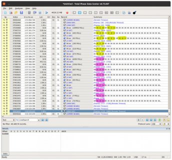

Thanks a lot for testing and sharing your thoughts on your findings so far. I concur with your plausible assumption.My gut feeling (guesswork) is the Arturia firmware is just throwing away data during those times, because we weren't polling rapidly enough
Thinking (out loud) about this problem some more, the Arturia must be failing to transmit some MIDI messages (otherwise they would appear in the packet capture), but it's probably in response to something we're doing (or not doing, or not doing well enough) on the Teensy side.
My current theory is the Arturia probably has 1 or 2 packet buffers and if it wants to transmit another packet when the buffer(s) are full, it probably just discards the data rather than waiting. Or maybe it overwrites the waiting data. If this is really what's going on, it would explain why all attempts to reproduce it with Teensy 4.0 are unsuccessful. USB MIDI device code on Teensy 4.0 won't immediately drop outbound data if the USB packet buffers are full. But whatever firmware exists on Arturia probably does.

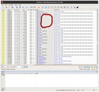

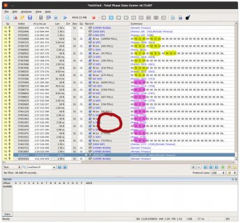

My guess is the missing Note Off message probably was generated during this time with the red circle, where no IN poll attempts occurred.

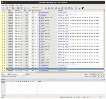

Here is another run where 2 Note On messages were missing. It also has a substantial time where no polling occurred.
My gut feeling (guesswork) is the Arturia firmware is just throwing away data during those times, because we weren't polling rapidly enough.
I still need to compare with the PC and with a USB hub, but my guess is the Linux MIDI driver allocates a lot of buffers. The hub case is complicated because Arturia communicates with the Transaction Translator inside the hub (since it's 12 MBit/sec) and Teensy uses split transactions at 480 Mbit/sec to talk to the TT. But the TT probably implements as least a couple buffers. Later tonight or tomorrow I'll look more carefully at the polling behavior downstream of the TT.
