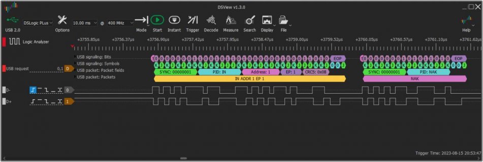

I can do some of it, using the Saleae Logic Analyzer, but it does not handle the 480mbs communications
The Arturia MIDI controller is a full-speed device, not a high-speed device.
But your Saleae remark triggered me to check what my logic analyzer could do.
Well, it can decode USB messages but that's about it...useful packet triggering is not available. So not really of help here.
