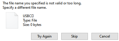

but hangs on writing to the disk.
After the hang and restart it does create a 0 byte file
Volume name:
Volume type: FAT32
Cluster Size: 32768 bytes
Volume size: 30771511296 bytes
 Space used: 131072 bytes  (459 ms to compute)
Files:
                          0 USBC
but if there is problems with this file - if you try and erase it in windows it gives an error message

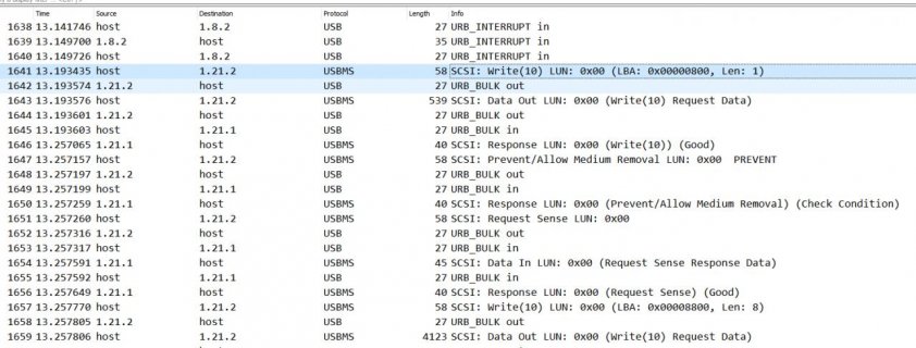

with the write files test sketch I am seeing the following:
  CSWResult: 0 CD:28
msProcessError()
65536 bytes  (1027 ms to compute)
Files:
checkConnectedInitialized()msReadBlocks()
msDoCommand()
USBDrive CallbackOut (static)
transfer->qtd.token = 0
USBDrive dataOut (static)31
55 53 42 43 0E 00 00 00 00 02 00 00 80 00 0A 28 00 00 00 88 40 00 00 01 00 00 00 00 00 00 00
USBDrive CallbackIn (static)
USBDrive dataIn (static): 512
42 20 00 49 00 6E 00 66 00 6F 00 0F 00 72 72 00 6D 00 61 00 74 00 69 00 6F 00 00 00 6E 00 00 00
msGetCSW()
USBDrive dataIn (static): 13
55 53 42 53 0E 00 00 00 00 00 00 00 00
msProcessError()
checkConnectedInitialized()msWriteBlocks()
msDoCommand()
55 53 42 43 0F 00 00 00 00 02 00 00 00 00 0A 2A 00 00 00 88 40 00 00 01 00 00 00 00 00 00 00
USBDrive dataOut (static)512
msGetCSW()
transfer->qtd.token = 64
USBDrive dataIn (static): 0
[COLOR="#FF0000"]ERROR Followup
[/COLOR]msProcessError()
[COLOR="#FF0000"]CSW Tag Error: 253
msProcessError()
CSW Tag Error: 253[/COLOR]
Writing to test.txt...checkConnectedInitialized()msReadBlocks()
msDoCommand()
55 53 42 43 10 00 00 00 00 02 00 00 80 00 0A 28 00 00 00 15 A2 00 00 01 00 00 00 00 00 00 00
CSW TAG Errors???
It looks like it sent the bytes but then no response from usb stick.

It does look like there is no response but this:
does not make sense. CSW size should be 13 bytes if I remember correctly. not sure where the 64 bytes are coming from. I should be getting my device tommorow. I need to read up on this again. Been a while:)
Edit: found this:
3.3
Host/Device Packet Transfer Order
The host shall send the CBW before the associated Data-Out, and the device shall send Data-In after the
associated CBW and before the associated CSW. The host may request Data-In or CSW before sending the
associated CBW.
[COLOR="#FF0000"]If the dCBWDataTransferLength is zero, the device and the host shall transfer no data between the CBW and the
associated CSW.[/COLOR]

Good Morning All
Was curious how the problematic drive behaved on windows vs one of my microcenter ones that work fine with USBHost.
Test 1. Copied the same files from the PC to each drive.
Image 1: UAM6 - start of copying files:
Image2: Microcenter 64gb drive
Looking at the Wireshark data I really didn't see a difference. But may help to debug whats going on with mass storage.
@wwatson - @KurtE
loaded the wireshark files up on google will send you all the invitation
ee1 - UAM when first inserted into PC - look for 1.20.x addresses
ee2 - UAM copying files from PC to drive
ff1 - micro center 64gb drive inserted into pc - look for 1.21.x addresses
ff2 - copying files from pc to drive
