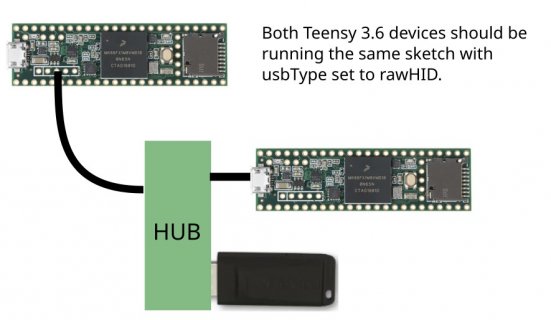

// Make sure to compile for RawHID USB type.
// This sketch assumes you have migrated the latest changes to the MassStorageDriver
#include "USBHost_t36.h"
USBHost myusb;
USBHub hub1(myusb);
USBDrive usbDrive(myusb);
USBFilesystem usbPart(myusb);
USBHIDParser hid1(myusb);
RawHIDController rawHID1(myusb);

bool onReceiveHidData1(uint32_t usage, const uint8_t* data, uint32_t len) {
return true;
Hi, thank you again, both Sandisk drives working now, CSW error is gone, but Kingston Datatraveler G2 keeps initializing infinitely as shown here. Maybe the unit is too old and is faulty but works on Windows, what I've noticed is when I plug into PC the led light flashes, aswell when writing/reading, but not when I plug into teensy even being detected and reported in log.
