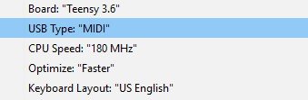

Here's a sketch to show that the USB Host MIDI driver is causing the Mass Storage driver to fail.
Both teensy devices should be running the same sketch included below. If the test is performed without the second teensy connected to the USB host port, it will complete successfully. If the second teensy is connected to the USB host port, starting the file system will fail.
The output from the debugger is included below the sketch.
// Make sure to compile for MIDI USB type.

What USB type are you building for?

I performed your test as best I could---I was still using T3.6 devices. I performed the test 10 times, each time I power cycled the teensy connected to the computer, leaving the hub, flash drive, and second teensy connected. Out of the ten tests, only once did it complete.
while (usbMIDI.read()) {
I'm aware of this issue. I had added the call myself after I posted, just in case that was causing the problem.
Alright. I've found something else. If I reduce the speed of the T3.6 connected to the computer from 180 Mhz down to 96 Mhz, the test always completes.
I am setup for testing now. @mjs513 I am getting the same results as you. Everything seems to be working except un-plugging and replugging the flash drive. I can't remember, but has a powered hub been tried?
Can you confirm that the device connected to your computer is T3.6 and the speed is set to 180 Mhz? No, I'm not testing with a powered hub at the moment.
