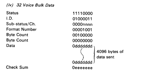

If my calculations are right (and MIDIOX displays the blocks right) I receive 3584 bytes (14*256 blocks: 1 sysex start block with F0, 13 sysex continue).
So there are 3 blocks missing to get to 4102 bytes:
- 2*256 continue
- 1*8 bytes sysex end (with F7)
I do not understand what you mean :confused:

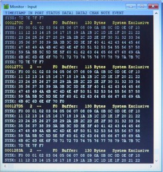

Sketch in post#23 ran on bare T4.1 usbType MIDI, Win10, IDE 1.8.19 TD 1.56, produced this:-
Note the second block, finishes with F0 and has 115 bytes, should be 130.
If you run the sketch as it is, monitoring, received blocks scroll upwards and when a faulty block is received is easy to spot. Good idea to have Actions open with cursor on Stop Display ready to click. Makes it easier to find the dodgy block.
Just play with it, change chunkSize and delayAmt. Occurrence of truncated blocks seems pretty random, does seem to happen more frequently with larger blocks.

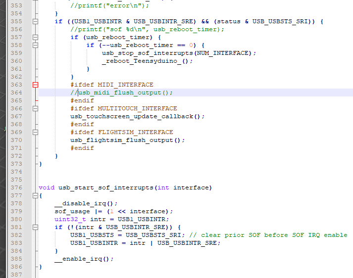

Did you change the usb.c in your Arduino Library as I suggested ?
After that it is important that your project has to be completely recompiled (restart Arduino IDE).
File Path: C:\Program Files (x86)\Arduino\hardware\teensy\avr\cores\teensy4\usb.c
Change green text in line number 364

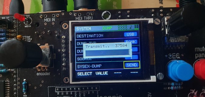

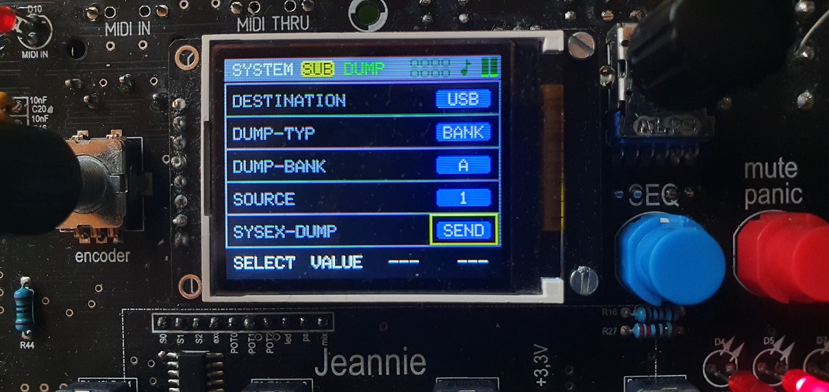

This is my code to send SysEx to usbMIDI()
In the SysEx dump menu from my synthesizer I query a key and set the sendSyssExflag.
If the flag was true then send sysex dump. I always send a block of 348 bytes.
Then I increment count for the number of sysex blocks and send the next block.
After each block I call a usb_midi_flush_output().

I wrote a small Arduino sketch and tested it on a Teensy 4.1 board.
Transmission errors occur with unchanged usb.c file. With the change to usb.c file, there is no transmission error.
The waiting time after transmission of a data block is very short.
Press Button on Teensy Pin A3 (low activ) send 128 SysEx data blocks.

Been able to reproduce this with the following sketch:-
#define chunkSize 128
#define delayAmt 100
byte data[chunkSize];
void fillBuff() {
  unsigned scratch;
  for (uint16_t ct = 0; ct <= chunkSize; ct++) {
    scratch = (ct & 0b01111111);
    data[ct] = scratch;
  fillBuff();
  usbMIDI.sendSysEx(chunkSize, data, false, 0);
  delay(delayAmt);
Monitored with Midiox.
When the error occurs, a block may be shorter or longer than is supposed to be.

I wanted to be sure, so I've checked the official Yamaha documentation. See page 37 here :
http://synthmanuals.com/manuals/yamaha/tx7/owners_manual/tx7e1.pdf
I don't see any problem with long sysex messages. Like the MIDI Sample Dump Standard you can send samples.

Commented out line 364 C:\Program Files (x86)\Arduino\hardware\teensy\avr\cores\teensy4\usb.c as you suggest and no longer have truncated sysex. Thank you for finding it Rolf.

SysEx Dump works now. See short video.
It was a bit more complicated than I thought. First, conversion routines had to be developed for all 212 parameter values in the Jeannie, which convert 8/16-bit integer values and 32-bit floating-point values into a 7-bit format for the SysEx dump. The same had to be converted back again.
This was followed by functions for the transmission and reception of SysEx data. Last but not least, a simple menu for operation had to be developed.
The transmission path is selected with Destination (Midi or USB)
DUMP type is either a patch or a bank.
DUMP-Bank sets the bank (A-P) for transmission or reception.
Source is either the patch no. or when receiving the space in the selected patch bank.
SYSEX-DUMP is set to send or receive SysEX data.
The "Load/Save" button starts transmission or reception.
A progress bar shows the progress of the transfer.
Video: https://youtu.be/xRoLsR9HgU0

I think it's a bug in the teensy 4 USB library. Paul should know what doesn't work there.
I modified the usb.c in the midi library. It works. But it's not a good solution.
Change red text in line number 364
