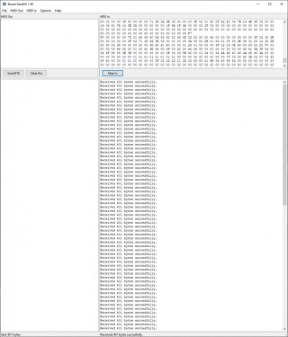

Hello Paul and rvh
For a neutral test, I reinstalled Arduino 1.8.19 and Teensyduo 1.56 on my Win10 machine and tested Teensy 4.1 sending SysEx data to the PC.
I sent 128 blocks of 401 SysEx bytes each and found no error.
My SysEx function is very simple. I fill a *buffer with 401 byte SysEx data (0xF0 + data + 0xF7) and send it with the command: usbMIDI.sendSysEx(sysexLength, sysexBuffer, true)
After sending a block ( 401 bytes) I always wait 20 ms and draw a progress bar. Then I send the next block. I'm not using usb_midi_flush_output().
Youtube: https://youtu.be/xRoLsR9HgU0
Grüße aus Deutschland, :)
Rolf

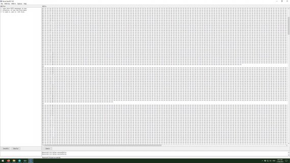

Here is the code from #89 again, but with the flush command already commented out, so you can use it as is.
#define MESSAGESIZE  212
  pinMode(2, INPUT_PULLUP);
  delay(1); // allow time for pullup to bring pin 2 high
void delayMicroseconds_WhileDiscardingInput(unsigned int usec) {
  elapsedMicros t = 0;
  while (t < usec) {
    usbMIDI.read(); // read and ignore incoming USB MIDI
  if (!digitalRead(2)) {
    byte patchData[MESSAGESIZE] = {0};
    patchData[0] = 0xF0;
    patchData[MESSAGESIZE-1] = 0xF7;
    for (int P = 0; P < 100; P++) {
      for (int i = 0; i < 6; i++) {
        patchData[3] = i;
        patchData[4] = P;
        usbMIDI.sendSysEx(MESSAGESIZE, patchData, true);
        //usb_midi_flush_output();
        delayMicroseconds_WhileDiscardingInput(5000);
  usbMIDI.read();
When I run this on my system (Win10 pro), I get errors in SXsend like this:
