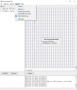

Here a screendump with the default Optimize: "Faster" setting:
1 to 5 messages truncated 3 bytes short with every 600 messages sent.
Paul

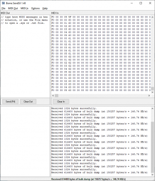

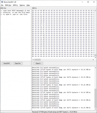

While searching for a clue about the difference between the "Fast" and "Faster" compiler options, I noticed that when I changed the MESSAGESIZE from 212 to 512 or 1024, the "Faster" option did not give errors [while MESSAGESIZE 212 still does at "Faster"].
Using the "Fast" option, all 3 message sizes worked fine.
I'm a bit lost and do not really know where to search from here.
Paul

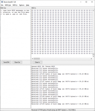

When I run this on my system (Win10 pro), I get errors in SXsend like this:
