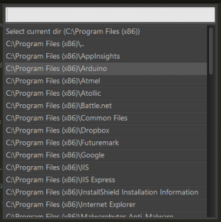

I then followed the instructions in the readme to install. You need to setup your path to the Arduino IDE that has Teensy installed in it. I ran into a couple of problems like my Sketch folder was too big to load, so he fixed it. There was an issue on searching for libraries, which he fixed...
So this morning I was able to build for T3.6 and I build and downloaded (using TyCommander) the test program I am doing for testing out adding DMA to the ili9341_t3n library...
And I did not have to edit the platform.txt file like I was doing before.
