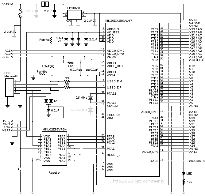

I want to power my Teensy 3.2 with external power (e.g a generator that supplies 5V) and e.g run the blink program. What do I have to do for that? So where do I have to connect the 5V and GND cable to?
See the schematic here:
If all you want is to power the unit externally, connect +5V to VIN and GND to GND.
If you want to be able to run the unit on the external power supply AND / OR using USB, then you need to:
1) Cut the trace between VIN and VUSB on the underside of the Teensy
2) Fit a Schottky diode from VUSB to VIN (depending on the size of your diode you can use the pads on the underside of the Teensy for this).
3) Fit a Schottky diode from your +5VDC power supply to VIN.
That way, either USB or your external power supply can provide power to the voltage regulator without issues. Whichever power supply provides the higher voltage will provide all the current drawn by the voltage regulator. Thus, both cathodes have to point to VIN while the Anodes point to VUSB and +5V External power, respectively.

So I could do the following: Connect 5v power to the VIN pin, GND to GND pin (with cables coming from a voltage generator) and then, if I'd cut the trace between VIN and VUSB, connect a usb cable to the mirco usb port of Teensy, reprogramm it, and be able to just pull out the cable again but having Teensy still powered on, correct?
Yes (as long as the external power is connected while you are programming the chip).
Found the trace zooming extremely in on the pinout diagram, so I know what to cut. But concerning the question of Xenoamor, is it really necessary to cut it for my purpose? (VIN will always be "exact" 5V when connected).
The cut is needed when the Teensy is powered on VIN or 3.3V, and USB will also be connected as that would be a second power source.
If you don't make the cut - the Teensy must be powered down before/while connected to USB with active power supplied.
If you make the cut only data and never power will come from the USB cable and then external power will always be needed to program or run.

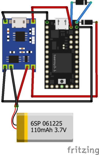

Beginner here,
I'm trying to use the Teensy in a portable project with a 3.7V LiPo or Li-ion battery
For charging, I use the TP4056, which has over-discharge, over-charge, over-current and short-circuit protection.
Just making sure, but If I cut the trace between the Vin and VUSB, on the back of the teensy 3.2,
And make the circuit as shown:
diodes used are schottky diodes
1) I could charge the battery from the micro-usb port of the Teensy
2) I could power the Teensy with the battery
3) Because VUSB (~5V) > VIN / VBAT (~3.7V), the Teensy would use the power from the micro-usb port over the battery when both are connected.
This is important because if the Teensy's micro-usb and therefore the TP4056 charge pins receive power, but the battery is being used, the over-discharge functionality on the TP4056 does not work.
