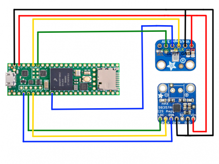

I am trying to use a trendy 4.1 to take the input of two microphones and send the combined signals to a speaker. I thought that I2S would be the best protocol for both the inputs and output because of the teensy audio library's I2SQuad function but when I try and use my I2S microphone (Adafruit I2S MEMS Microphone Breakout - SPH0645LM4H) with my I2S amp (Adafruit I2S 3W Class D Amplifier Breakout - MAX98357A) only the microphone works, until I disconnect it's clock pins and then the amp begins to work, even though I am using I2S1 for the microphone and I2S2 for the amp so the clocks should be independent from one another. How can I fix this, should I use different microphones/amps?

And I have attached a diagram of my wiring.

This looks wrong:
C++:
AudioConnection patchCord2(i2s1, 1, filter1, 1);
That connects a microphone to the cutoff frequency control input of the filter, which is unlikely to be what you intended. (Your diagram doesn’t actually show a second microphone, though your original post says it’s there.)

Thanks for the response, you are right I did not mean to connect the microphone to the cutoff frequency control input of the filter. When I comment out the connection between the i2s input and the mixer as suggested I don't hear anything through my speaker however when I also comment out the initialisation of the i2s input I do hear the reference tone through my speaker, so I believe the hardware works. I also tested the microphone, when the i2s output is commented out the microphone works fine. As for why I haven't wired up two microphone it's because I currently can't even get one to work with the i2s output. I have attached the altered code with the commented out sections to show how I tested the speaker.

Two quick things ... gotta go AFK for a bit ...
  • supplying the speaker amp from the Teensy 3.3V probably isn't great, it might overwhelm the regulator. Try the 5V (check, but I think it'll take it ... but be sure NOT to let 5V get back to a Teensy I/O pin, that'll kill it!)
  • I can't use exactly your connections, but I could do a quick test with AudioInputI2S2 as the input and AudioOutputI2S as the output. Nothing connected to the input, but the output was working fine. So you could perhaps do a quick try with the hardware and software swapped around

This worked perfectly, thank you so much for your help.
