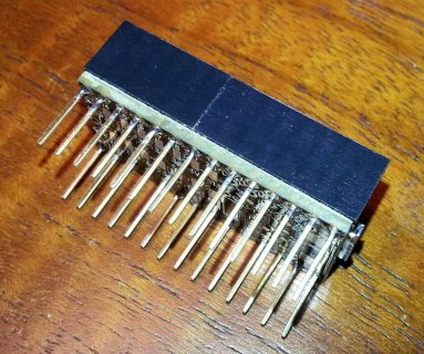

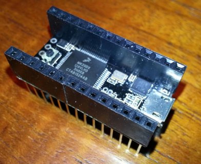

I just got my audio board and my wiz820 adapter and realized later there were special 14x1 headers available for them.
I think I may have found another solution though, to use some Arduino stackable headers like this : http://www.futurlec.com/Connectors/ARDHEAD8.shtml

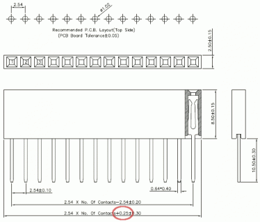

They don't have a 14x1 version but I think it can work by putting a 6x1 and 8x1 next to each other. The spacing might not be totally right but a little bit of filing should do the trick. Will report back if it works... Seems like a nice solution when you don't want to mount things permantly...
