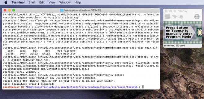

I'm trying to use the supplied Makefile to compile code for the teensy4
On my machine the Makefile is at /Applications/Teensyduino.app/Contents/Java/hardware/teensy/avr/cores/teensy4

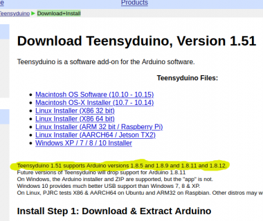

(I had initially installed Teensyduino over Arduino 1.8.11 but I understand this isn't supported - so I installed Arduino 1.6.13 and reinstalled Teensyduino. Teensyduino reports Arduino 1.8.11 and Teensy 1.5.0 but it also reports that there's an update available, as does Arduino 1.6.13 so I'm not sure exactly what's going on.)
I can succesfully compile the Blink example with the Makefile if I change Blink.ino to Blink.cpp and add #include "core_pins.h"
When I flash this .elf onto the Teensy nothing happens. The .elf file from the Makefile is 131K whereas if I compile the sketch using the Teensyduino IDE, Blink.ino.elf is 44K
The Makefile .elf contains these symbols:
Whereas Blink.ino.elf contains many more symbols:
Any suggestions?
Tims-MacBook-Pro:Blink tim$ nm /var/folders/29/gch7qs111rbcf0tflgp8cwtw0000gn/T/arduino_build_941999/Blink.ino.elf
