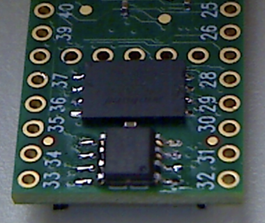

I tried using a W25N01 NAND flash memory chip (W25N01GVZEIG from Digikey) and a PSRAM chip (from PJRC) on a Teensy 4.1.
I could not get the NAND Flash to work on the narrower pads, but it worked fine on the wider pads. I used the LittleFS_QSPI_Simple_Datalogger.ino example to test it.
It is almost impossible to solder the W25N01 to the narrower pads and so it may be that I had a soldering error in that case.
So I tried putting a PSRAM chip on the narrow pads.
But I can't get the 8MB PSRAM chip to work when installed on the narrow pads when the WS25N01 is present on the wider pads.
I tried putting an image above.
Can this be done or have I done something that is not supported?

Definitely can be done. The W25N01 is supported is that slot using LittleFS. There are a examples in the LittleFS library that should help guide you.
In addition the Readme of the LittleFS Teensy library: https://github.com/PaulStoffregen/LittleFS, provides additional guidance. Look for the QSPI simple data logger example.

The W25N01 IS working (I am very happy about that!) with the LittleFS library using the LittleFS_QSPI_Simple_Datalogger.ino example you suggested, but I could not get the PSRAM to work with it.
Paul's memory test, https://github.com/PaulStoffregen/teensy41_psram_memtest/blob/master/teensy41_psram_memtest.ino , shows 0 memory.
I'll try another chip. I use the PSRAM in many projects and hadn't had any trouble so I thought I might have tried something that was not supported.

We used both together before without any issue so maybe try reflowing the soldering on that PSRAM. And sorry misunderstood.
So...
I desoldered the PSRAM from the Teensy, and soldered the chip to another Teensy by itself and ran Paul's memory test and it worked.
So I desoldered it and put it back... and it works. So it must have been a soldering error.
I evidently made a poor connection or left a whisker of solder across pads and did not see it.
