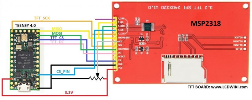

I am trying to use a Color 320x240 TFT Touchscreen with ILI9341 Controller Chip along with the audio shield Rev.C and Teensy 3.2.
I have gotten the screen to display an image with this setup, so I'm pretty sure my connections are all good.
I am now trying to run the XPT2046_Touchscreen library example called ILI9341Test. I have changed the #define's to the ones recommended for usage with audio board (also the way I have connected the board) but it does not seem to be working. The sketch uploads and compiles but the screen is just blank white (or gray).
I noticed in the README for the XPT2046_Touchscreen library it says "The normal MISO, MOSI and SCK pins will be used automatically." I'm not seeing where they are set or if I can change them anywhere.
#include <ILI9341_t3.h>
#include <font_Arial.h> // from ILI9341_t3
#define CS_PIN 8
//#define TFT_DC 9
//#define TFT_CS 10
// MOSI=11, MISO=12, SCK=13
#define TFT_DC 20
#define TFT_CS 21
#define TFT_RST 255 // 255 = unused, connect to 3.3V
#define TFT_MOSI 7
#define TFT_SCLK 14
#define TFT_MISO 12
//ILI9341_t3 tft = ILI9341_t3(TFT_CS, TFT_DC, TFT_RST, TFT_MOSI, TFT_SCLK, TFT_MISO);
XPT2046_Touchscreen ts(CS_PIN);
#define TIRQ_PIN 2
//XPT2046_Touchscreen ts(CS_PIN); // Param 2 - NULL - No interrupts
//XPT2046_Touchscreen ts(CS_PIN, 255); // Param 2 - 255 - No interrupts
//XPT2046_Touchscreen ts(CS_PIN, TIRQ_PIN); // Param 2 - Touch IRQ Pin - interrupt enabled polling
