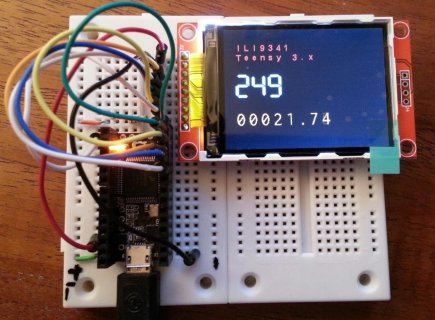

Yesterday I received a 2.2" ILI9341 LCD Display. I also just discovered the magnificent UTFT library by Henning Karlsen.
It was very easy to get it working with the Teensy3.0. I probably had it working withing 45 minutes of unpacking the display.
I am using the latest version of software and libraries. Teensyduino 1.18, Arduino 1.0.5, and UTFT V2.75
The UTFT library was just updated a couple of weeks ago, and has Teensy3.x support built in.
The UTFT Library is located here: http://www.henningkarlsen.com/electronics/library.php?id=51
The ILI9341 LCD display is very sharp, bright and clear, however it seems very slow compared to my older 1.8" ST7735 display.
Does anyone have any ideas to speed up the display rate?
Here's an image of the display:
Click here for video: ILI9341 - Teensy 3.0 Video
Here is the code from the example above:
Notice there are no delays in the code above, so I would expect the update to be much faster.
I assume that it's the SPI communications with the ILI9341 that is the bottleneck.

AliExpress ILI9341 2.2 Inch 240*320 SPI TFT LCD Display
http://www.aliexpress.com/item/Wholesale-1PC-2-2-Inch-240-320-Dots-SPI-TFT-LCD-Serial-Port-Module-Display-ILI9341/1188518505.html
ILI9341 ............. Teensy 3.x
VCC ................. 3.3V
GND ................. Ground
CS .................. 10
RESET ............... 8
D/C ................. 9
SDO (MOSI) .......... 11
SCK ................. 13
LED ................. 100 Ohm -> 5V
SDO (MISO) .......... 12
