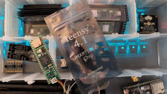

Hi All, I've been away for a very long time. I first posted here in 2013 concerning the Teensy 3.0.
I have a few Teensy 4.1 boards now, and after working with the Pico (and the W, 2, 2w) and the ESP32-S3 N32R8 WROOM 2, I have had some success with my current project. But after hitting yet another brick wall, I thought maybe it is time to bring one of my Teensy 4.1's out of its static wrap and see what it can do with my project.
I wanted to post here my needs to see if someone that is experienced would think it is possible and how easily it could be accomplished. I do not need to be taught how, but maybe some references to reading would be helpful. I just wanted to ask before I start yet another fork off the highway down scary dark dirt roads and down deep rabbit holes with no solution.
My project uses multi MCU boards and a bit complex, but for this function/portion, I want to use a platform to handle reading audio files from a micro SD card (32gb) through a SPI sd card module, and send audio out using I2S to a decoder, then feed a stereo 3w amp module to two tiny speakers. I will use other MCU boards to handle visual interaction... RGB lighting, TFT displays, interaction using buttons, and the WiFi connection. So my Teensy 4.1 will need to be able to handle two SPI connections because one of those SPI ports ties all my other MCU's together for communications. The other SPI of course is for the micro SD card.

@HopWorks: Since you are planning to make use of the T4.1, you might want to use the T4.1's onboard microSD socket in place of adding an external SD card reader. The onboard interface should be much faster & would have the additional benefit of not tying up an additional SPI interface. Reading from the microSD & generating sound at the same time can have some unique timing challenges, but there are a number of posts here on this forum where doing so has been successfully implemented and/or demonstrated.

I have to look at them again, because I do not remember a card reader on the board, but I do remember the 4.1 version. Sure enough, there is one WOW! I bought these both in 2022 back when they were a bit cheaper at $27 US. I never opened the packages though. Thanks for the heads up! Had I remembered they had their own card reader and about what you said with the on board interface being faster, I would have targeted these and been a week into it already.
