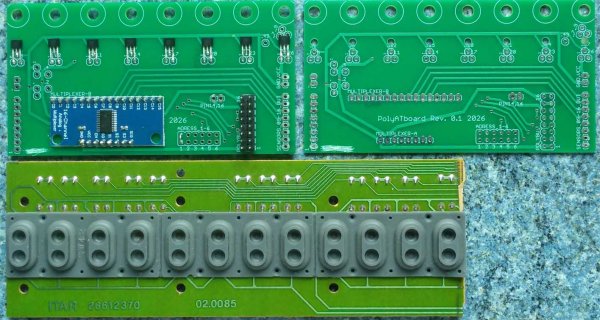

Thanks again for the excellent explanation. I am still having trouble understanding the JP1 socket in the schematic. I understand the SJ7-9 are solder jumpers to select one for each SIG for A0-A2. Allowing you to use the same board for each MUX. Where does SJ1-6 go to? Also, What are the values of C1 and R1? I am sure R1 and R2 are the same value. I remove the underlines in PIN_D0-3 to get your code to compile. Was I wrong to do this? I apologize in advance for my lack of understanding and your patience with me who should know more about electronics and C programming to be allowed on this forum.
Actually it makes me happy that I can help and that anyone is interested :) And all what counts is that you are asking correct questions :)
That is correct.
As I mentioned earlier in this thread originally I was thinking about implementing power-saving feature that would allow me to temporarily turn off the power delivered to Hall sensors, SJ4 and SJ1 are connected to transistors that power up Hall sensors. The other end of SJ4 and SJ1 would go to digital lines of microcontroller (Teensy) that would allow me to control power delivered by Hall sensors. But currently I abandoned idea because Hall sensors when powered down take significant time to power up and become fully stable (like 50μs), so I am afraid I would not be able to turn them on/off sequentially at desired scan rate (1kHz) without problems. That is my assumption, I did not check it in real-life yet. Still, if I ever come back to the idea of power saving I will have hardware ready. So for the time being SJ4 and SJ go to ground (meaning transistors Q1 and Q2 deliver power to Hall sensors constantly.
The value of C1 is 100nF. Typical decoupling cap. R1 and R2 resistance is 2kΩ but these values are not critical - should be just enough to saturate transistors when connected to ground.
No, actually you are right :) . They should indeed be PIND0, PIND1, PIND2 and PIND3.
Final comment: please note that the original mux schematic was for my keyboard only setup (3 muxes, hence SJ solder jumpers allow three connections only). If you want to adapt the schematic, you would of course need to expand that to cover 12 muxes.
As for myself, in addition to mux boards presented in this thread, I have have a separate board for 3 muxes that handle all 48 pots, microcontroller, connector for flat cable (to connect keyboard muxes), connector for RGB strip and ribbon controller (Softpot), see my previous message: https://forum.pjrc.com/index.php?th...aftertouch-for-teensy-synth.75078/post-363366
I really should read the entire tread a lot more carefully. I keep missing critical information. Grounding the transistors will free 9 pins for a total of 12 analog inputs for a 16 wire cable:) .
Would you mind giving me more code on how you correct each key difference and determining when the after touch begins taking readings. Having code you already created would be a real time saver. If you coded this in the STM32F103 that requires difference programming, I am sure I could code the Teensy for this myself.
Sure I can help you with the code but my current code is very complex so for purpose of demonstrating the idea, you need something easier.
In principle, no matter how precisely you setup your Hall sensor there are going to be differences between them.
If you looked at the picture I posted earlier, these are actual readings from 48 sensors:
As you can see the "off" values vary a lot (from 2500 to 2800). On values are more consistent (1300-1400). You are going to see different values in your setup due to different distances between sensors and magnets, different magnet strength, different characteristic of AD converter.
So how do you deal with that? What I am doing is storing per-key minimum and maximum value ever read. Then I arbitrarily pick levels of 1/3 and 2/3 of the key travel distance as key off and key on points. This creates hysteresis that prevents from "bouncing" - i.e. avoids generating several false note on/off messages due to noise from AD readings.
The code that implements this idea is here. I wrote it for illustration purposes here as a starting point of your own endeavor. It builds upon previously posted example

This code assumes that you are doing "calibration" first - just press all keys one by one at least once. This would set min/max ranges for each key appropriately.

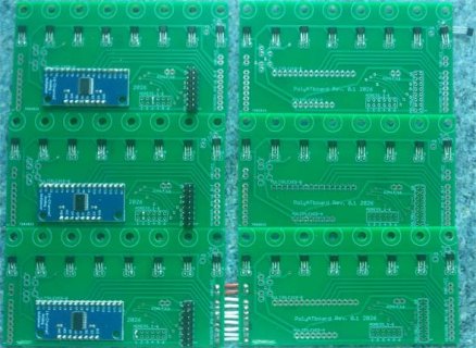

Thank you for providing me answers to all my questions. It time now for me work on this project. Building the pedal will take a lot of my time.
Some more progress. I have now added more Teensys :) the synth is now 8-way multi-timbral, had independent arps for each channel, plus drum machine channel. I also added foot controller (based on basic Arduino Mini) that sends MIDI to main synth. This way I can still play something when I run out of hands :)

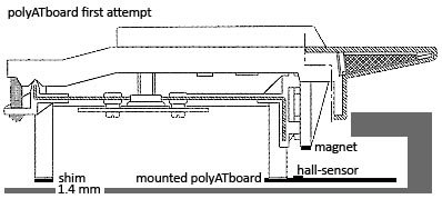

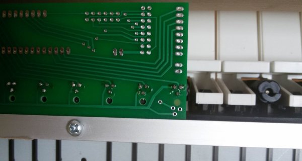

That triggerd me to design my own pcb that fits to a fatar keybed to "re"midify it. I am still waiting for some small magnets for further attempts.
But the first attempts with your code are promising. Here is a sketch of what I am trying to do and a picture of the first mounted pcb.

Since you are using Fatar keybed, did you purchase it separately or are you upgrading existing midi controller. I am asking because from what I know Fatar does not sell keyboards to customers and the only place I know where you can buy Fatar keyboards alone (for DIY projects) is Doepfer (Germany). Also what model of Fatar keybed are you using? It looks like 61TP/9S ?

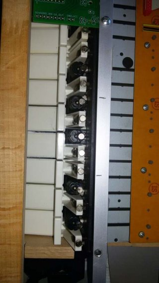

The first test with small and cheap magnets gave ambivalent results: Your basic code is working. But the analog values do not seem to be high enough.
The round magnets (4x1mm) seem to be to poor/small and to far away from the hall sensors. The highest analog value I get is 2500 the inital values are from 1950 to 2150, my hallsensors are running on 3.3 V. Reversing magnets will not suffice.
Next step is ordering bigger magnets (5x2mm) - that will result in smaller distances and more magnetic strength. Another problem is the position of the magnets on the black keys, these are a little bit higher than those of the white keys. Eventually this could be solved by code.
I am using 6x2mm neodymium magnets that are pretty strong. My hall sensors use 4.5V supply (5V - 0.5V drop on transistor switches). That makes output range significantly higher.
First test with the stronger 5x2mm magnets shows initial values from 2000 to 2150. Those increase up to 3000 (white keys) and 2800 (black keys). Increasing the pressure more shows 100-150 on top. That will be good for further attempts. And with 16 hall sensors connected they need to be stabilized - but the boards are prepared. ;) BTW: UV-Glue will be a better choice than Alleskleber.

:) Most of the soldering is done, only connections to the daughter-mux-boards and capacitors are missing. Top right you can see hall sensor number 49 - this one will get an extra analog line. First tests are promising.
