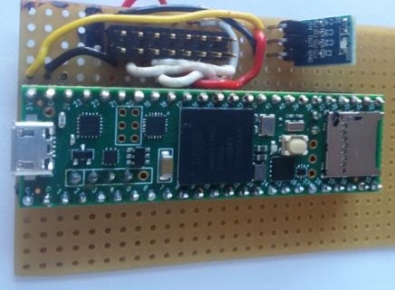

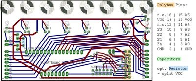

It took a little time - the hardware (49 hall sensors and 3 multiplexers) are up and working with a step down converter.
Now it is coding time...

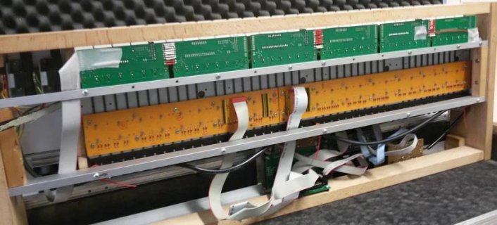

After spending some time in regulating the distances of the magnets and bending the sensors (the holes beneath the sensors helped :) ). My first idea was: Generating arrays with estimated and not measured analog values could do for the minimum and maximum values of the fatar keybed. (BTW: Next time I must be more precise with positioning the magnets! - I still have another 5 octave TP8S with broken AT and some spare PCBs...) And the estimated maximum values must respect the different distances between the magnets of white and black keys and the sensors.
And I need time of flight sensors as ribbon controller alternatives additional to the pitch bend and modulation wheels. I did some promising experiments with VL53L0X and a capacitive touch screen with a nice user interface ... :cool: enough work for the next year.
One more time thank you.
After adapting your code to my south-north turned magnets and therefore "growing pressure values" for key presses - it worked fine. But I'm not happy with the differences of the black and white key action of the Fatar keybed...
I will use more arrays one with static values that represents the color of white or black keys
