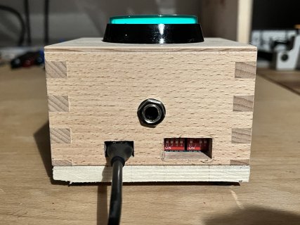

This one sends out dedicated Keystroks (USB HID Keyboard), USB-Midi and traditional MIDI.
The Keystrokes are even faster recognized as USB-MIDI by DAWs etc!
Both Keystrokes or MIDI can be chosen from a set of most used or know types like:
(SPACE, ENTER, Arrow Down... etc for Keys and/or MIDI Note, PRG-Change or MSC)
It is based on a Teensy LC.
I built a big lighted tactical switch in a nice wooden case. On the back it has a 6.3mm jack plug for connecting a footswitch.
With the DIP switch you can select the desired keyboard command or MIDI command.
The project is based on my LetsGO controller, which has already been built many times.
Both projects can be downloaded including source code, description and schematics on GitHub.
