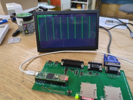

I'm laying out a prototype board and thought I'd make sure.

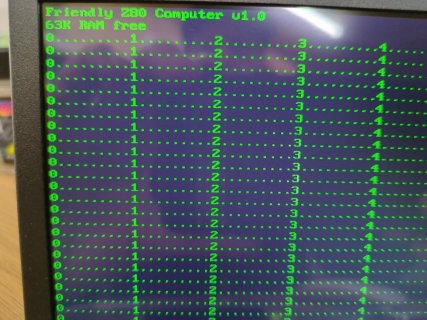

Even though it took using all 8 timer registers, it turns out it is possible to use one FlexIO module (FlexIO2 in this case) to generate VSYNC, HSYNC and drive 4 data lines to get 16-color VGA output. All the framebuffer data is fetched using DMA (one channel for regular mode, three channels for line-doubling) leaving the CPU free for other tasks. Mono/1bpp mode is also supported if low memory usage is required, using two shift buffers as state registers to broadcast the single pixel bit to all four output pins.
#include <DMAChannel.h>
/* R2R ladder:
 * GROUND <------------- 536R ----*---- 270R ---*-----------> VGA PIN: R=1/G=2/B=3
 * INTENSITY (13) <---536R -------/             |
 * COLOR: R=11/G=12/B=10  <-----536R------------/
 * VSYNC (34) <---------------68R---------------------------> VGA PIN 14
 * HSYNC (35) <---------------68R---------------------------> VGA PIN 13

FWIW, dropped the library into my new board, with the resistor tree using 180/390 ohms, into a 7 inch VGA monitor from AliExpress, the library from Github, and it umm worked first time. That's not right but I'll take it!
640x480 and 800x600 work great, but 1024x768 makes an artifact, I haven't spent ten seconds diagnosing it, could be LCD setup. Later on that. 640x480 is best for text size on the small screen so that will be it for now, and 800x600 would be just fine.
Characters are sharp! Distortion in the 2nd/right image is the phone, close up.
CPU overhead seems to be 50 to 60 uS per second, nice!
(The Teensy is doing the text, emulator isn't running yet.)
