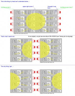

I'm working on a display screen (with Adafruit Neopixel WS2812 Strip), where Teensys are in the middle of the screen, which is split in parts (see the image for exemple).
But every x/y offset and Layout possibilities give the same results :
I use movie2serial to send the video, and VideoDisplay in each Teensys.
I have no skills with coding (but I learn and I try !), and I thought that just "playing" with the offset and layout in VideoDisplay will give the expected result.
Is there something I miss (I'm pretty sure of that) ?
I see on the OctoWS2811's page, that the video X and Y offset are "The upper right corner of the portion of the video this Teensy should display".
But in the exemple we find on the OctoWS2811's page, this parameter for Teensy 1 video X/Y offset is 0/0 in the middle of the screen, so I don't understand.
Thanks for your explanations !
