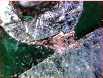

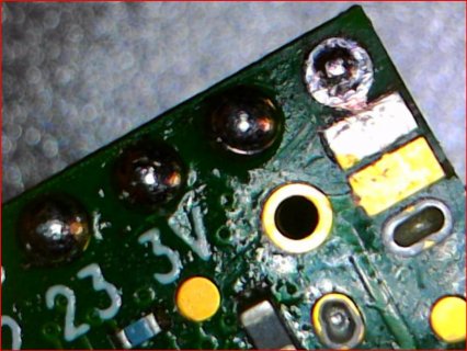

Hi there, I just soldered the pins on 4.1 board. Looks like the Vin pin is too close to the USB pad. Is there a bridge on the board there? Can I use it as is in the pictures?
Thanks,
They are supposed to be connected. It is this wire on the schematic.
This connection allows you to easily get access to the 5V power, or to power the board by putting 5V on the VIN pin
