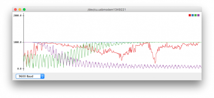

So now I was curious - and it was eager to see the frequency response on the filter as the Teensy executed it. And I remembered the new functionality of the "serial plotter" in the Arduino IDE. Some first test had been disillusioning - but after some research I found a little solution - well, this is more of a decent hack - which enables me to plot several curves in several colours in the serial plotter like this:

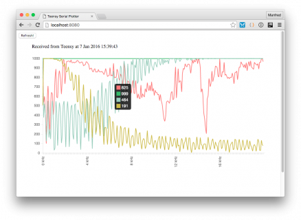

This is the result of my test application, you find the source when scrolling down. The thing is: the "serial plotter" when opened, will set numerical values via "Serial.println(<a number>);" as Y-Values in the plotter window, the X-Value is always the "next tick", means the next call of "Serial.println()" moves one "tick" to the right (step is 1/500 of the axis).
So you may not postion a value at an absolute position in the X axis, right? Wrong! ;-) There is a solution.
At first it's good to know, that the plotter always scales an array of 500 values over the X axis. it's hard coded - I looked into the original code ... Not very elegant, but helpful to know. So I prepared a buffer with 500 values, and I copied my values to plot into this buffer, the X position scaled to 500 possible positions according to the expected corrdinate. This was the first "hack". The second one is evil ... if you call "Serial.end();" before plotting your data, then after a liitle delay, restarts with "Serial.begin(<baudrate>);" - the next plot will be set at the position X = 0. So if you have prepared your values to plot in the described 500 values array, you may now plot them nearly at once and the stop the serial output again with "Serial.end();". And they will always be on the same position - the plotted values won't scroll out of the screen as usual.
With this solution I'm now able to compare several response curves altogether, also because there is a new feature in the plotter: if you print a comma separated list of values as "Serial.println('<val1>,<val2>,<val3>,<val4>');", these will be printed as several Y values on the same X axis postion - and in different colors as well! These colors you may also customize, therefor you have to search the file "theme.txt". Unfortunately this file lies in the system path of the Arduino IDE, so if you know what you are doing, there is no problem to define the desired plot colors by yourself (mind the backup!). Look for the section "GUI - PLOTTING". Example follows.

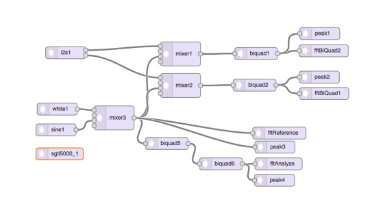

For my little test I plugged some audio objects together, so I may examine some filters via white noise as input and an FFT object to analyze the frequency spectrum, or I use the sine generator and sweep the frequencies by myself and measures the results via the "peak" object. Both ways do their job, but the sweeping method seems a to be a little more accurate.
This is the test application in the Audio System Design Tool (be aware: you need the Arduino IDE 1.6.7 and the current beta version of "Teensyduino" and Pauls audio adaptor to implement the following sketch):

AudioConnection patchCord1(sine1, 0, mixer3, 2);
AudioConnection patchCord10(biquad5, biquad6);
AudioConnection patchCord11(mixer1, biquad1);
AudioConnection patchCord12(mixer2, biquad2);
AudioConnection patchCord13(biquad6, fftAnalyze);
AudioConnection patchCord14(biquad6, peak4);
AudioConnection patchCord15(biquad2, fftBiQuad1);
AudioConnection patchCord16(biquad2, peak2);
AudioConnection patchCord17(biquad1, fftBiQuad2);
AudioConnection patchCord18(biquad1, peak1);
AudioConnection patchCord2(white1, 0, mixer3, 0);
AudioConnection patchCord3(i2s1, 0, mixer1, 0);
AudioConnection patchCord4(i2s1, 1, mixer2, 0);
AudioConnection patchCord5(mixer3, 0, mixer1, 2);
AudioConnection patchCord6(mixer3, 0, mixer2, 2);
AudioConnection patchCord7(mixer3, biquad5);
AudioConnection patchCord8(mixer3, fftReference);
AudioConnection patchCord9(mixer3, peak3);
AudioControlSGTL5000 sgtl5000_1; //xy=116,468

... and an example for a customized "theme.txt" file:
# GUI - PLOTTING
# color cycle created via colorbrewer2.org
plotting.bgcolor = #ffffff
plotting.color = #ffffff
plotting.graphcolor.size = 8
#plotting.graphcolor.00 = #2c7bb6
#plotting.graphcolor.01 = #fdae61
#plotting.graphcolor.02 = #d7191c
#plotting.graphcolor.03 = #abd9e9
plotting.graphcolor.00 = #e41a1c
plotting.graphcolor.01 = #377eb8
plotting.graphcolor.02 = #4daf4a
plotting.graphcolor.03 = #984ea3
plotting.graphcolor.04 = #ff7f00
plotting.graphcolor.05 = #ffff33
plotting.graphcolor.06 = #a65628
plotting.graphcolor.07 = #f781bf
