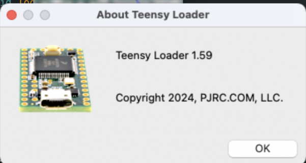

This assumes the reference voltage is 5V, for Teensy 4.x it is 3.3V.
Also make sure you have Teensyduino 1.59 or higher installed; earlier versions don't automatically disable the pin keeper on the analog pins which can interfere with readings.
float batteryVoltage = (sensorValue * (5 / 1023.00))/0.090909; //0.090909 is (R2/R1+R2)
I double checked and I do have version 1.59 installed. Before when I tried 3.3V, I didn't have anything connected it to the pin and it read ~7.8V and I thought it didn't work. Tried it now with the 3.3/1023 and got dead on readings with something connected to the pin. When I disconnect it shoots up to the ~7.8V reading which I assume is just noise from the board.
But it works and thats what matters because once the pin is soldered to, it should get noise. Thank you for your help!
