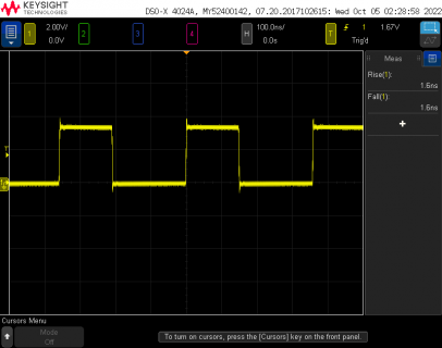

I'm pretty sure there is a serious problem with the circuitry connected to Teensy, or perhaps in the way it's connected, rather than the problem being slow rise time. But what circuitry problem could be, I can't even begin to guess because I can't see your circuitry or even know what really is, other than some sort of H bridge motor driver.
But I can comment on the rise time. I ran a quick test with this simple program, which uses only the default settings, nothing special to configure faster signals speed.
  pinMode(1, OUTPUT);
  noInterrupts();
  digitalWrite(1, HIGH);
  delayNanoseconds(100);
  digitalWrite(1, LOW);
Here is the waveform my oscilloscope sees. On the right hand side you'll see I turned on the scope's measurement of rise and fall time. Both are measuring 1.6 ns when viewed at this scale of 100 ns/div.

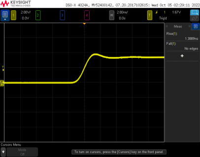

Here is a zoom in to the rising edge, as fast as the time scope on my scope can go, only 2ns/div. Here with higher resolution the measurement turns to 1.39ns. But really you could argue the rise is about the width of 1 division, depending on where you define the stop and stop of the rise.
Also consider the scope's rated bandwidth is only 200 MHz. If you apply this 0.45 rule of thumb for scope bandwidth versus rise time, it's quite possible my scope might have more than 200 MHz bandwidth. If we call this rise time 2ns and apply that 0.45 ratio, it would mean 225 MHz. If the rise is 1.39ns and the 0.45 rule applies, this would be 324 MHz bandwidth.
My point is the rise time is very fast, so fast that even my 200 MHz oscilloscope probably isn't fast enough to accurately measure it. And you can see on the vertical scale of 2 volts/div that it really does rise up to 3.3V, with a small overshoot. I was awkwardly holding a small wire between Teensy's GND pin and the scope probe ground while fiddling with the scope buttons to create these screenshots for you. Some of the overshoot in these images might be contributed from ground inductance that caused that piece of wire. Good quality high bandwidth measurements are difficult, and I did this quickly just for the sake of answering your question about the rise time.
But really my point is you probably have something really wrong with the circuitry or connection to Teensy if you're not getting approx 3.3V logic high. Whatever is wrong, causing your motor control to waiver, it unlikely to be the rise time. We could help you more if you show us what sort of circuitry you're using. Clear diagrams and photos might really help.

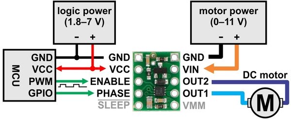

With all those motors hooked to the Teensy you may be drawing too much current, scope your Vin pin to see if the voltage is sagging.
I would guess you must have the motors wired in parallel instead of series but anyway if your driver looks like this...
You would wire the VCC pin with 3.3 volts as that determines the logic level.
You would wire the VIN pin with 5 volts assuming you have 5 volt motors.
