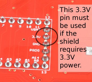

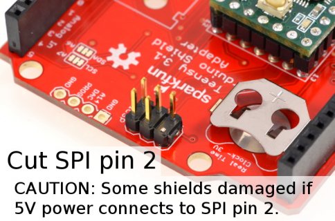

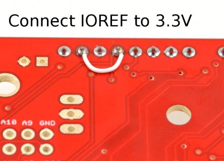

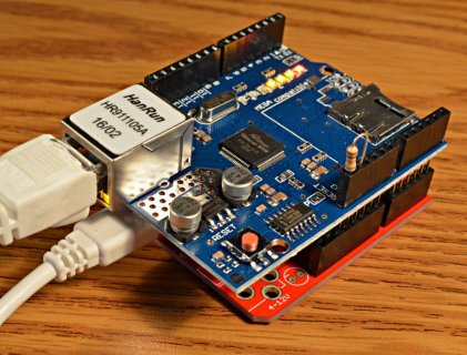

I've started work on a Teensy3-based project that interfaces with a W5100 Ethernet Shield by using a Teensy Arduino Shield Adapter. The crystal (DigiKey 300-1002-ND) was soldered to the Teensy, the adapter board was properly assembled, and I've soldered the Teensy+crystal to the adapter. When I stack the Ethernet board atop and run the following code, adapted from the TimeNTP example, the network lights are active, but the Teensy/adapter no longer responds to reprogramming/reboot requests nor does the COM port show up for any IDE (Arduino, UECIDE, etc) or serial terminal program. My current issues are twofold:
1) Does anyone have any ideas about best next steps to take to enable programming the Teensy while its stacked with the Ethernet shield?
2) Also, although the crystal is installed and the button battery is attached and charged, the Teensy does not seem to be keeping time when unplugged...
